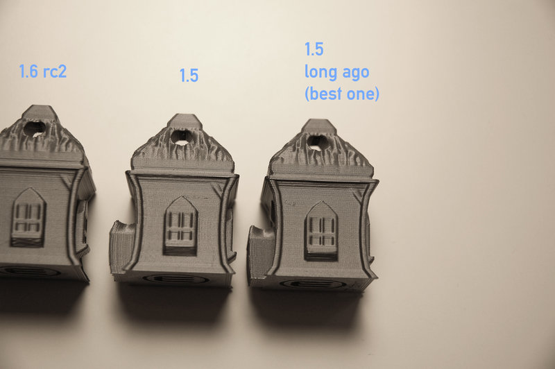

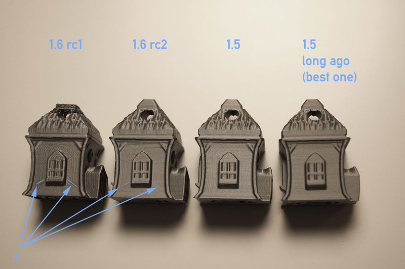

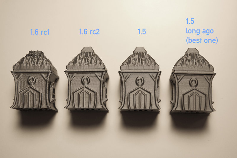

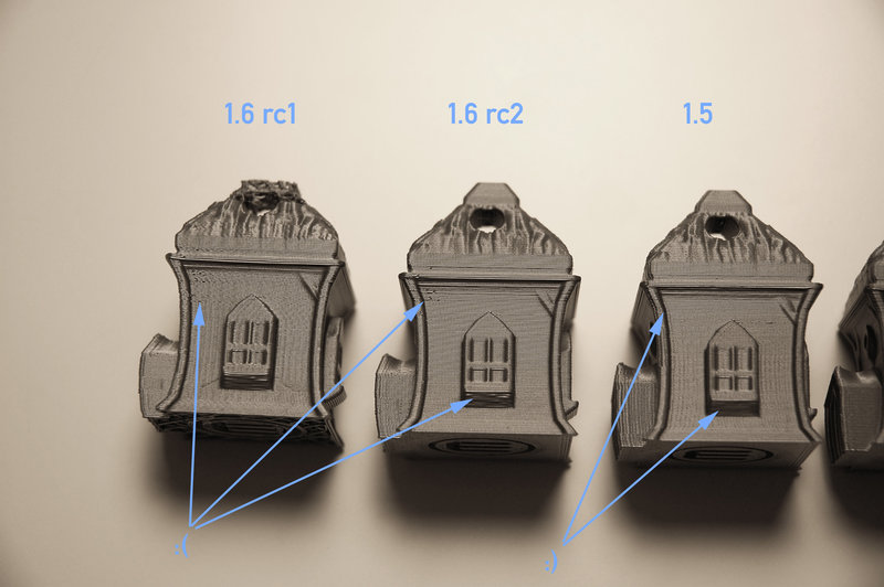

This is actually not a bug. Kind of my general concern rather. I attach photos with prints made of aluminium-PLA composite, but these artifacts are also there when I use plain PLA types.
So the problem is, the new Kisslicer seems to preform a little different from the old one in terms of aesthetics of surface..

Post by pjr »
Voyt
There's an interesting topic on ringing here: https://ultimaker.com/en/community/3532 ... rp-corners
Maybe try a reduced acceleration.
BTW, what did you do to get the Aluminium to print?
