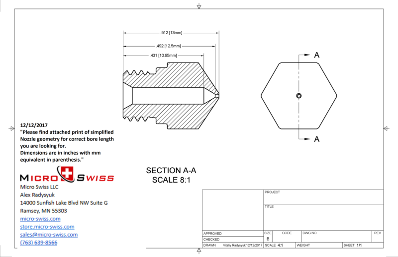

Here is information from Micro Swiss for their nozzles for MK10 style units (Wanhao Di3, Flashforge, Monoprice, etc)
