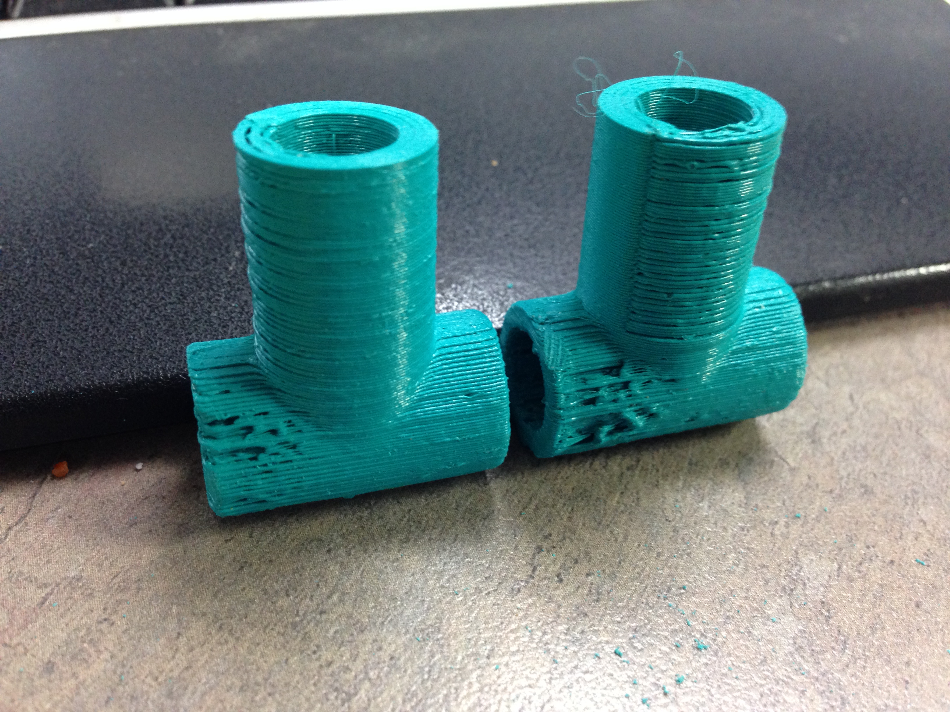

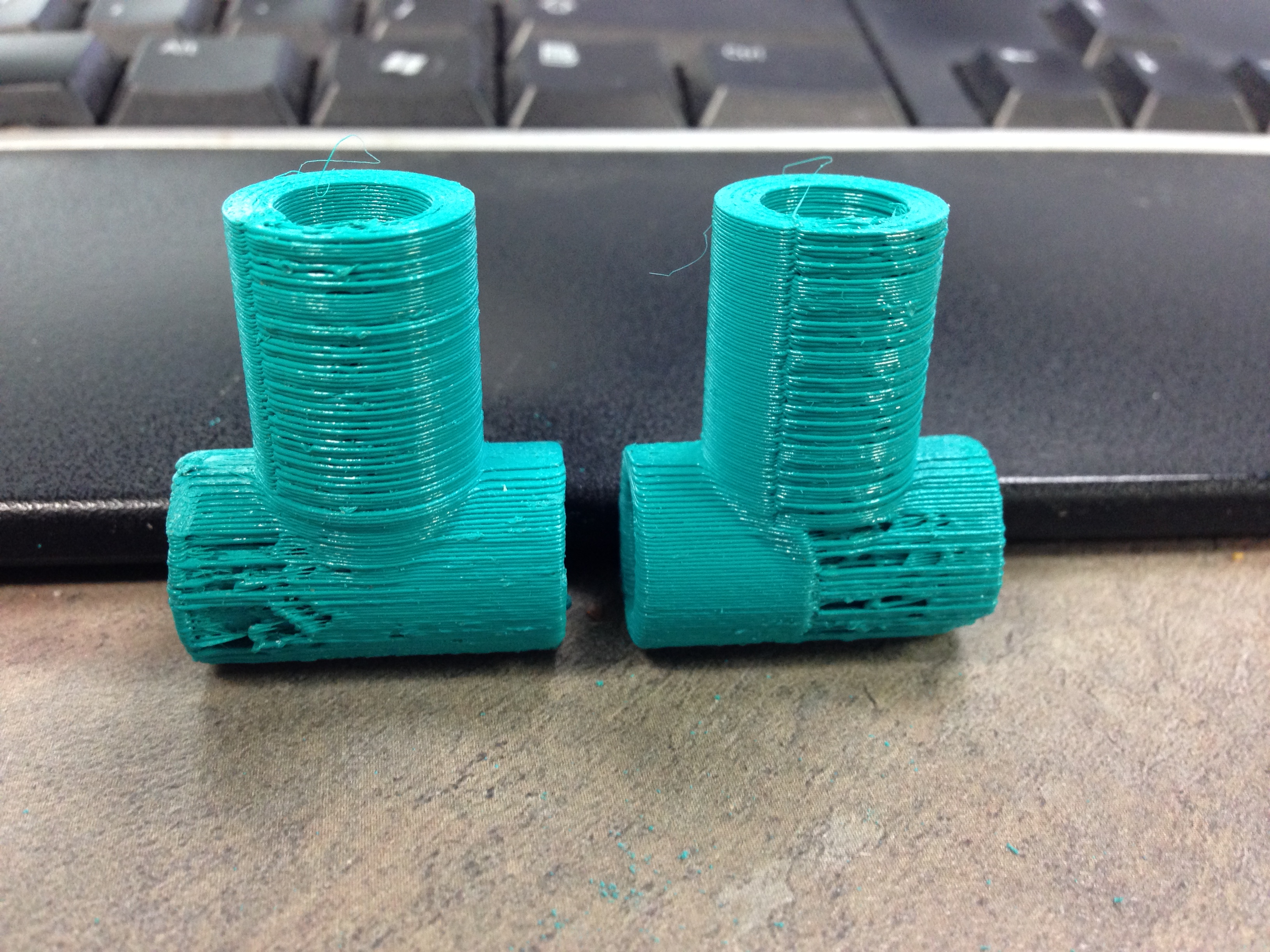

I have tried lots of setting, and still get a gap at the start of a loop or fill.
and no change to part if I change m227 or m228 values, or I'm not changing them enough to see the diff.
prime and suck have gone from 0.00 to .15 and all over in between and the change is inconsistent. some times it clears other time not.
thanks for your help

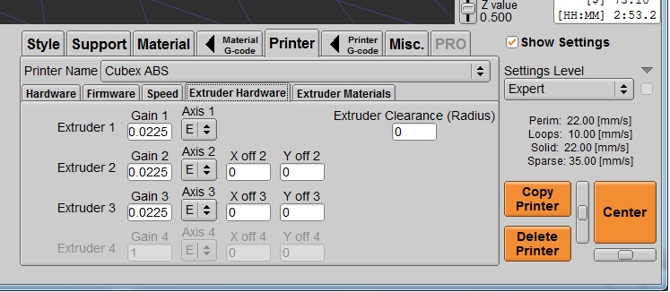

Also take a look at these gains, is this right for a Cubex trio? cant remember where I got them.
Re: still having gap issues
Bobby O'Seal wrote:I have tried lots of setting, and still get a gap at the start of a loop or fill.
BP
Gains are OK.

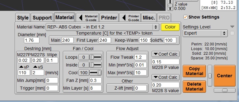

To find the right M227/228 parameters you better print simple part like described here :
viewtopic.php?f=20&t=1378&start=10#p3977
Start with
M227P = 0.06
M227S = 0.02
M228P = 0
M228S = 0.01

Hi Bobby
Giovanni is the best.
I don't even understand the m227 and m228 settings. I used the default setting.
When I take a look on your print, it's bad. My cube x haven't print that bad.
I have been testing different versions of KISSlicer and CubitMod versions.
Some how I don't believe CubitMod 6.05 would be best for your print.
You will get much better print result from
KISSlicer v1.5 beta and CubitMod 4.91 combination. CubitMod 5B5 also gives you nice print.
CubitMod 6.05 prints a net like body with open intended open gaps on the surface. It didn't print solid wall for me.

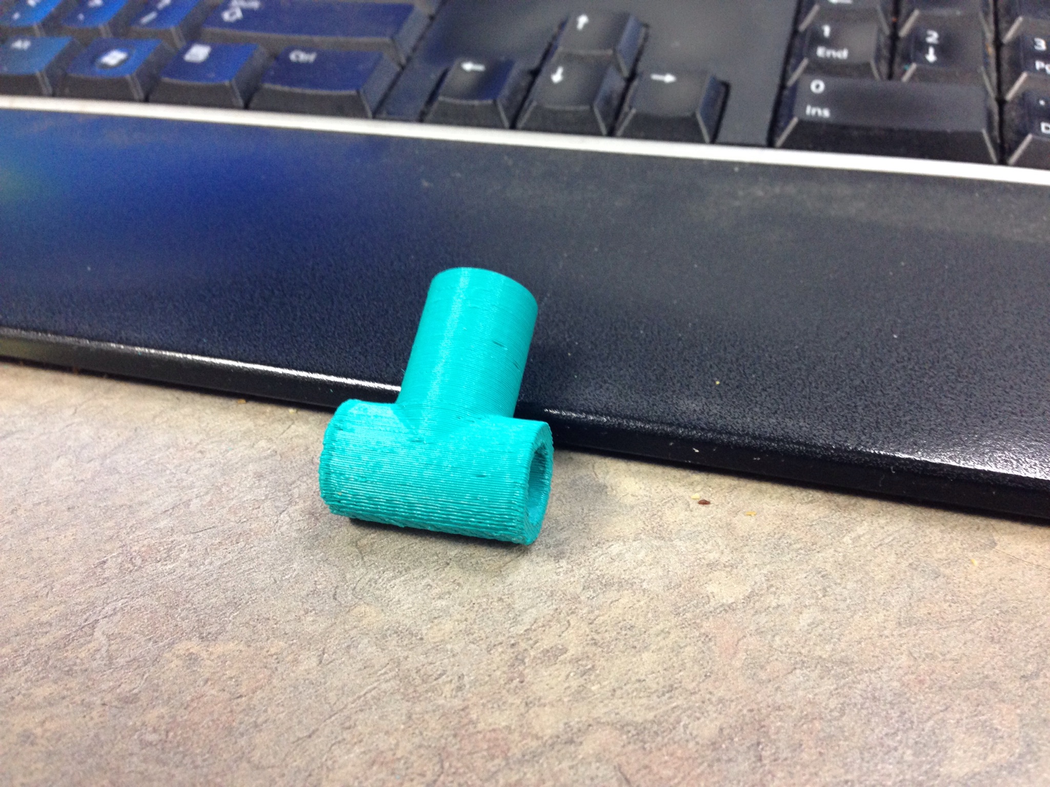

:D :D :D Yeah!!! :D :D :D
I downloaded the new ver of both and am now getting great prints!!!
still cot some fine tuneing to do, but very happy so far.
thanks for all your help.
