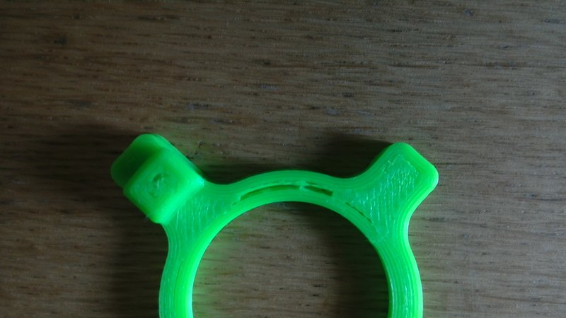

However in few prints I have noticed that the last top layers were like missing some steps. here is a pic to show you the problem. Any thought ?
Thanks in avance.
Top layers seem incomplete

Is your motor getting hot or do you hear any clicking? It might be that after some time printing it gets hot and starts skipping.
If that's not the case, you might want to check that your prime value is equal to your retraction value.
Good luck
Good luck

For what I can see from the picture, I thought at first, that your skin thickness is to small (under Style Tab), but then I count the skin/wall "loops" and it should be enough. Because the Skin Thickness determine both the wall and the "roof# thickness. What I would suggest you is to play with Extrusion width, Num Loops and Skin Thickness (all in the Style Tab).
Check the User manual and the tool tips too!
D.
