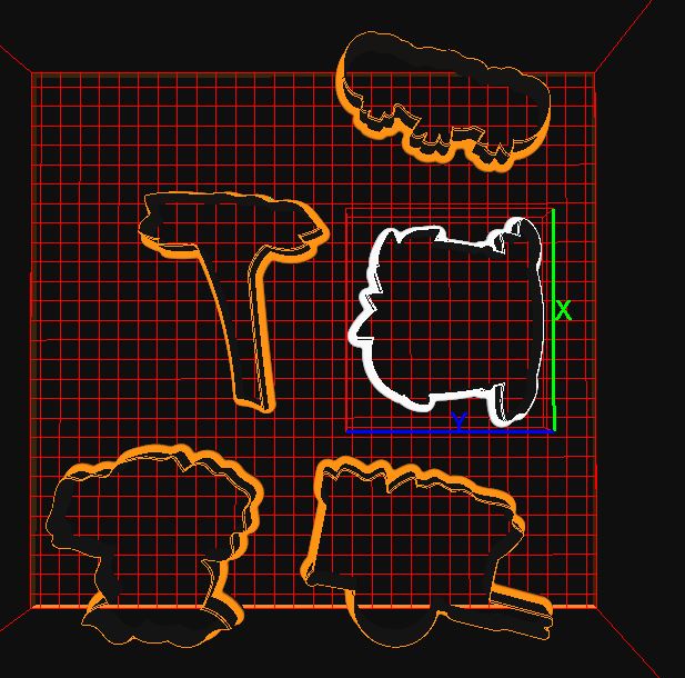

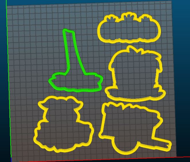

Is there a way to change the default part spacing for part packing? Since it does not seem possible to manually move the parts, changing the spacing would allow more parts to be placed on the bed.
I have attached an example of a group of parts I should be able to print on one bed but, seemingly cannot due to the part spacing used in Kisslicer.
Any suggestions are appreciated.
