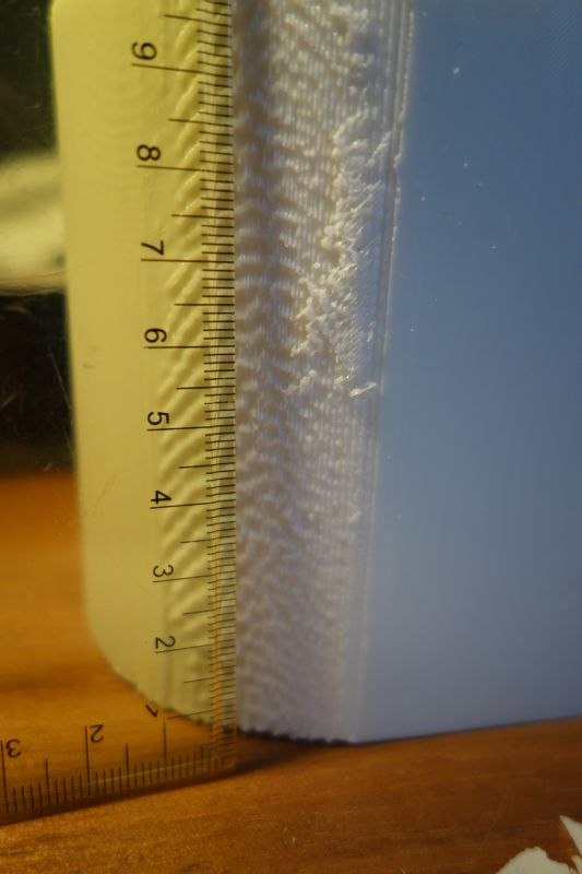

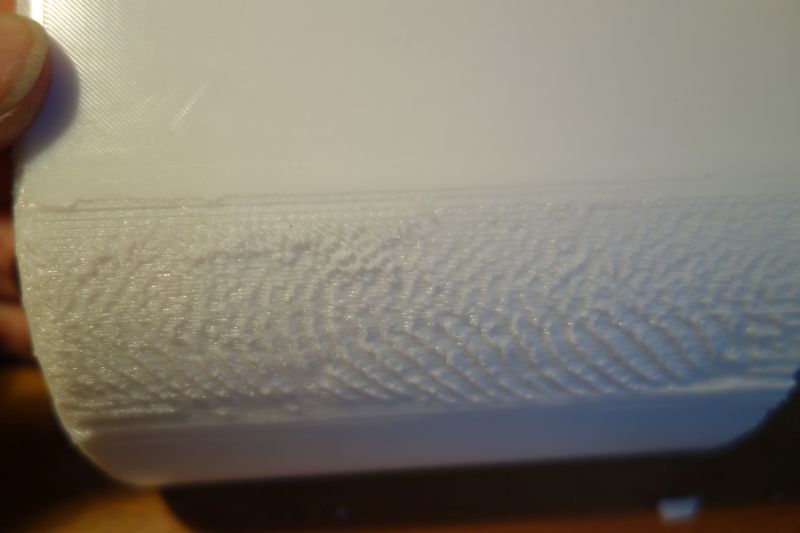

Every object I print that contains support structures shows a heavy rippled surface
in areas shielded by the support structure.
See attached pictures.
I think the support shields the print from the cold air from the printer's vents.
I already did some non successful experiments with the extrusion temperature.
Any ideas how to prevent the ripples?

- It's a millimeter ruler.
- ripples_3.jpg (71.46 KiB) Viewed 4441 times
- ripples_2.jpg (60.26 KiB) Viewed 4441 times
- ripples_1.jpg (60.82 KiB) Viewed 4441 times

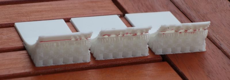

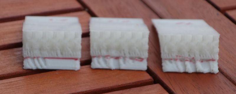

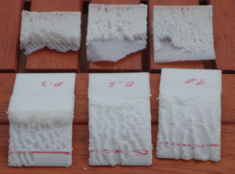

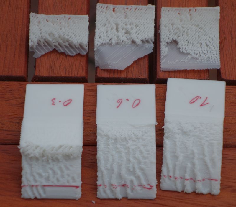

I had some time to experiment with the XY-gap parameter now.
My standard setting was 0.3mm and now I tried 0.6mm and 1mm, too.
As a test object I printed a 3cm wide cylinder segment with 2mm thickness. The cylinder has a radius of 50mm.
This is very close to the object from the start of this thread.
Well - I think the XY gap parameter is not the solution.
All three parts have been printed separately and on the same position of the print bed.
Pictures 1 and 2 show the parts out of the printer. The red line marks the upper end of the support.
From left to right: 0.3mm 0.6mm and 1.0mm gap
In pictures 3 and 4 the support is removed from the parts. Again from left to right 0.3 0.6 and 1.0.
I did not manage to remove the support completely from the 0.3mm example part.
Lothar
