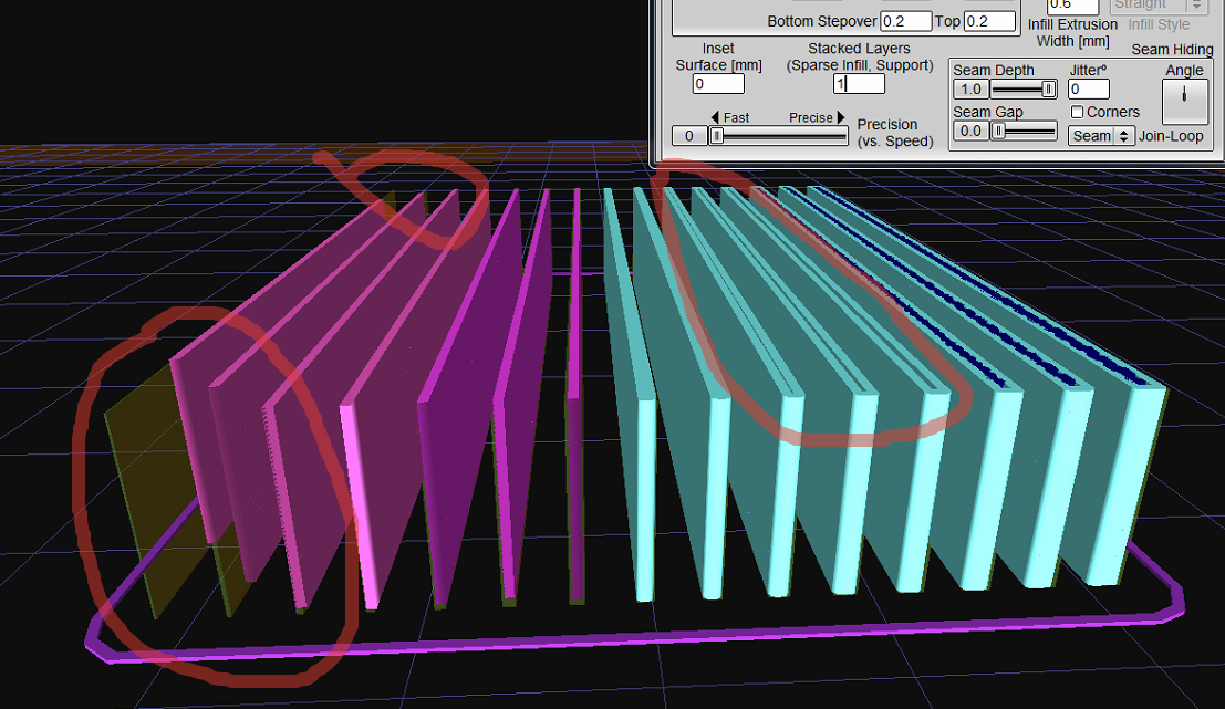

Bug?
Does not fill between the walls. Does not print thin walls.

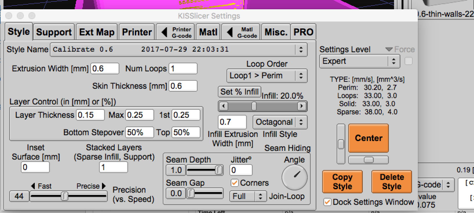

In the attached profile (thanks for including that!) the inset is 0.15, so for thin walls like you have in the test you are making them 0.3 mm thinner, which is a significant fraction of the extrusion width. I will try to make that more robust, but you can get the expected paths by resetting the inset to 0 if you no longer need it.StrannikZet wrote:Bug?

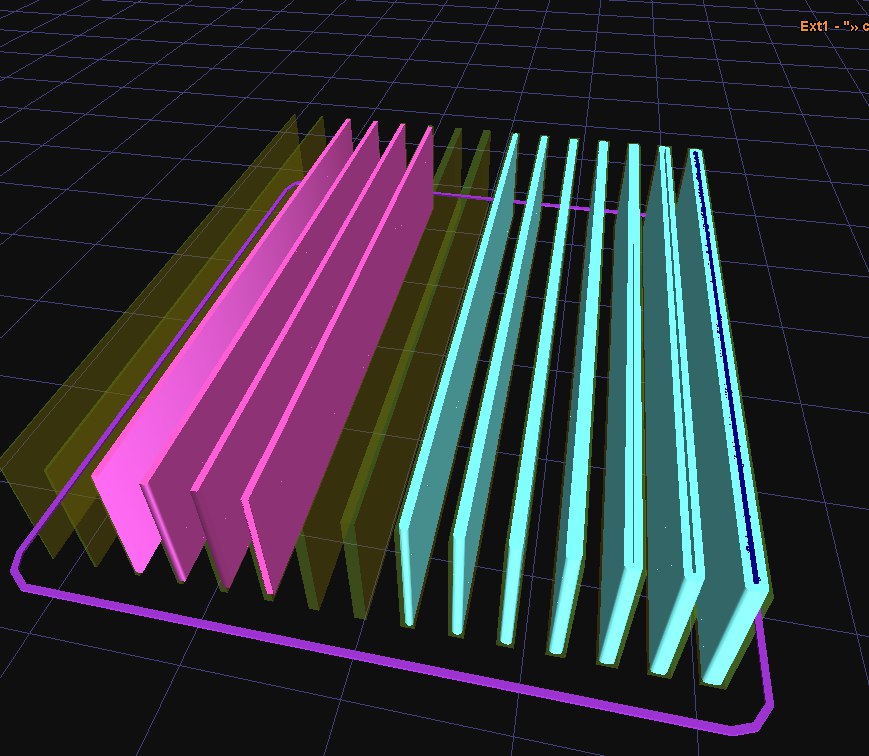

Ok. But what to do with what does not always fill the thin walls? Inset is 0. Thanks!lonesock wrote:In the attached profile (thanks for including that!) the inset is 0.15, so for thin walls like you have in the test you are making them 0.3 mm thinner, which is a significant fraction of the extrusion width. I will try to make that more robust, but you can get the expected paths by resetting the inset to 0 if you no longer need it.StrannikZet wrote:Bug?
