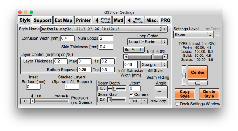

So, PreloadVE calibrated (0.25), seam is very good at bottom (bottom layers ~0.25mm), but very very poor on top (top layer ~0.1-0.15mm).
Is this a result of "Z-Settle = 0.5mm"? I captured that print head slightly moves up and down while nozzle continues extruding.

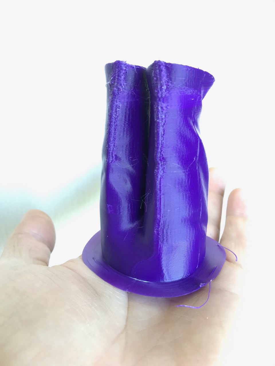

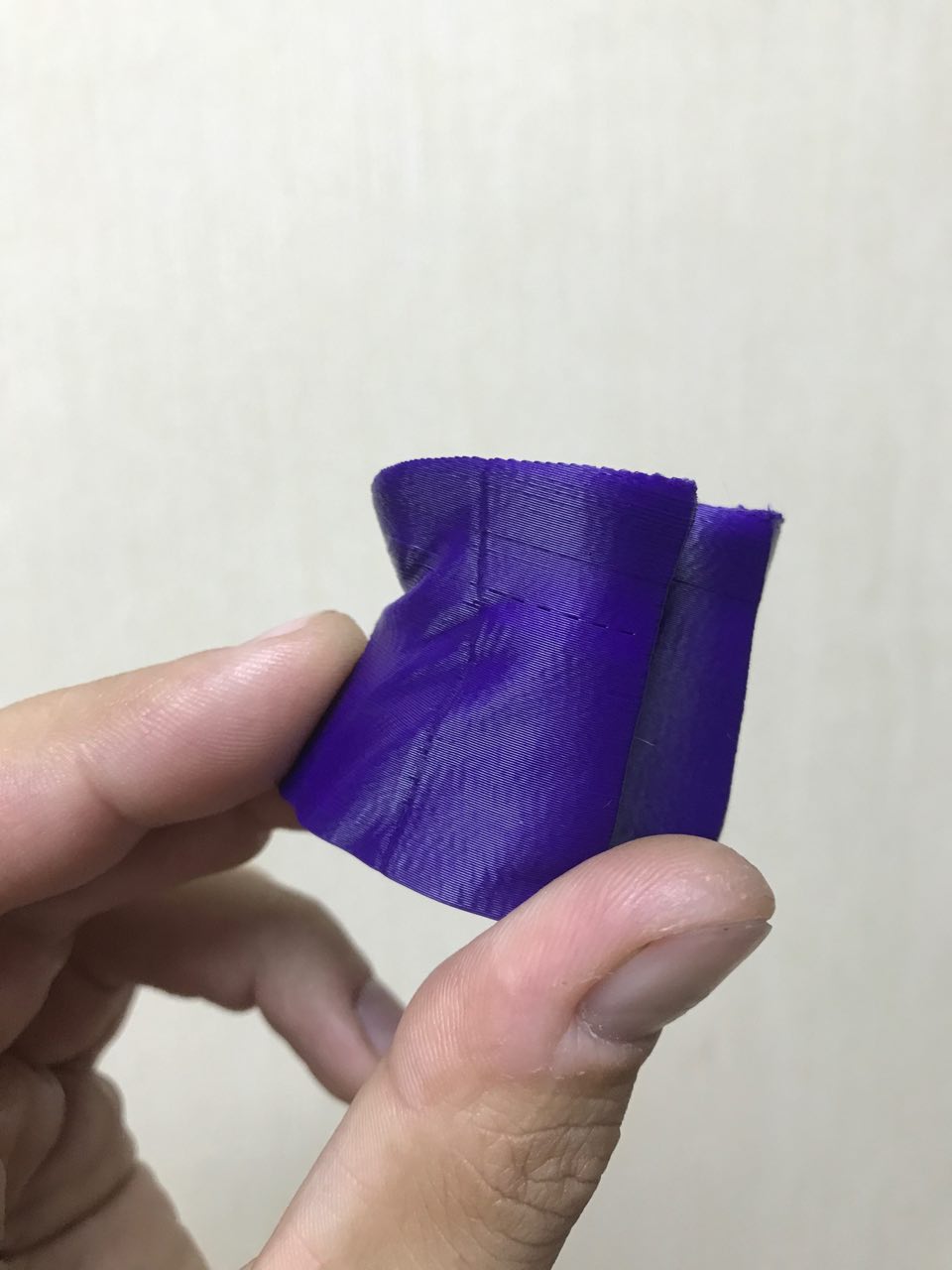

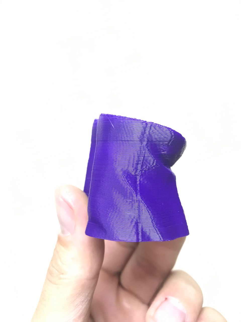

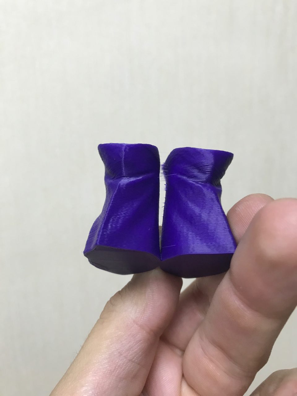

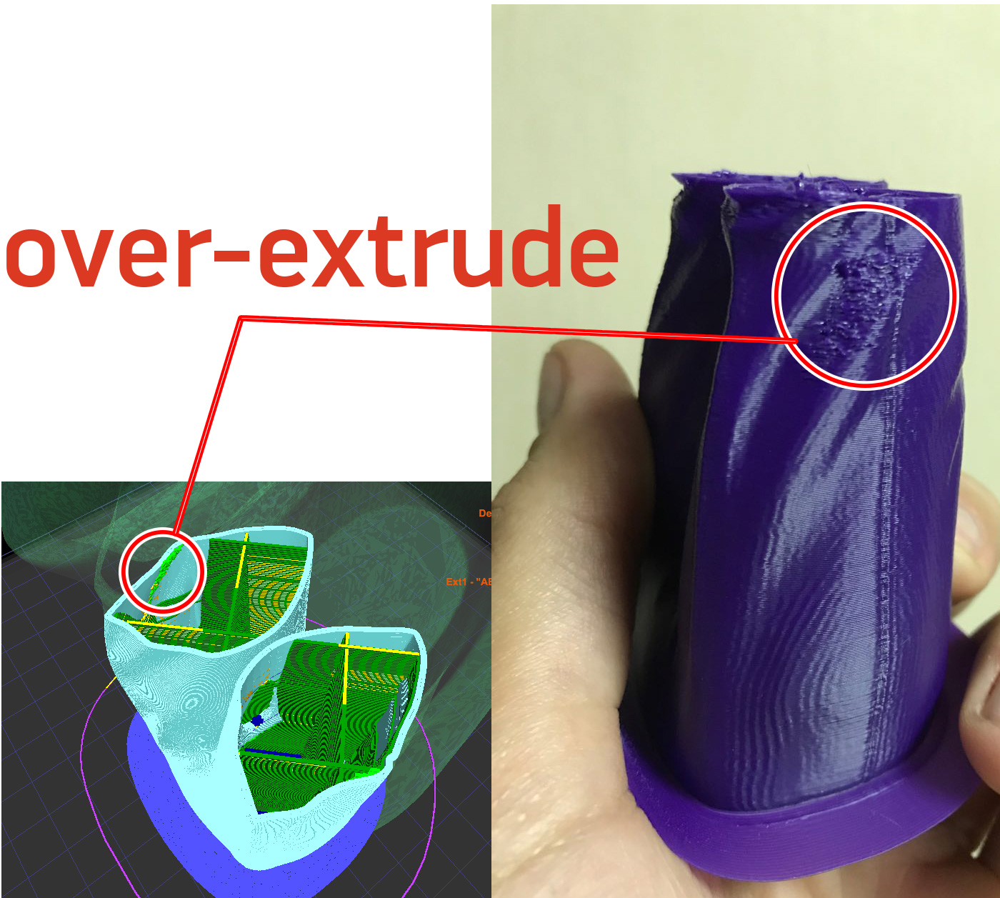

New KISSlicer make me crazy! a-a-a-a-a-a-a!
I printed few times same model with different settings, with stepover and without. So, PreloadVE calibrated very well, but quality of printed model - very very very very poooooor!
The main problem - is over-extrude (or no retract!) for layers with SparseInfill (I'm right? this is sparseinfill?)
model -> https://drive.google.com/file/d/0B8dro0 ... sp=sharing

What's your retraction setting?
- Posts: 34
- Joined: 12 Nov 2014, 08:53
post editedinventabuild wrote:What's your retraction setting?
so, retraction works perfect on loops/perimeters

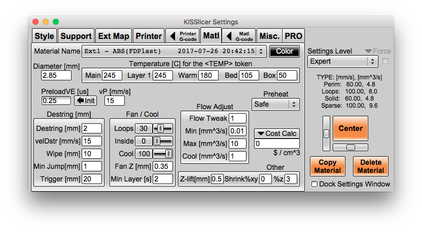

Hello abuharsky,
I'll do the best I can to help, but it might be several issues not all of which I mention here. I notice your Trigger is set to 20 mm which seems high to me if you want destrings and wipes on shorter segments of sparse infill travel moves. According to Dreide which can be found here viewtopic.php?f=6&t=332&start=10, the Min Jump and Trigger work as follows
"Wipes can be caused by:
Travel moves that cross perimeters or come really close to perimeters.
Changing to the next layer (which implies 1., but see below).
Travel moves that exceed the Trigger setting.
However, a potential wipe is suppressed if the according travel move is shorter than the Min Jump setting, with one exception: if the wipe has been triggered explicitly (cause 3) and is not followed by a layer change (cause 2), the wipe is actually not suppressed, irrespective of the Min Jump setting. In other words, the Trigger setting trumps the Min Jump setting, except when the wipe is (also) caused by a layer change."
Also, have you tried to run the same settings with PreloadVE turned off (set to 0) just to see if this new feature makes a difference the way you have it configured? Maybe you could cut the part down in CAD and test these things by printing only the section you're having problems with to save time.
- Posts: 34
inventabuild thank you for advice!
So, seems to be problem solved at "Min jump = 0" and "Trigger = 0", but too many retracks now
)), some additional noise
