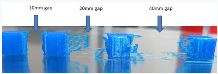

Peter, here's an interesting Destring test part. it consists of 4x10 mm cubes spaced as shown in the pic:
Destring Part - 4 Cubes
I found it in a MatterHackers post on eliminating ooze: https://www.matterhackers.com/articles/ ... -to-oozing

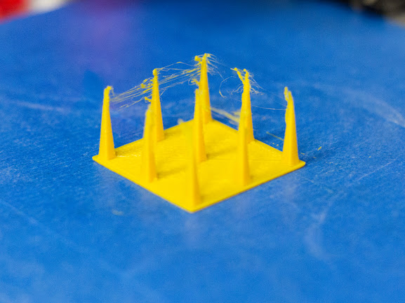

There's a lot of test parts like this out there:
9 Tapered Pillars
9 Tapered Pillars
In the Matterhackers post they talk about both retraction distance and travel speed being significant factors in eliminating stringing (obviously there's other factors as well). I always have travel speed for my cartesian printers set around 175 -200 mm/sec which is the recommended setting in alot of the manufacturer premade profiles. Not sure if they are designed to go faster or if faster would even be beneficial from what I've read. The deltas can travel much faster. Then there's the acceleration factor...

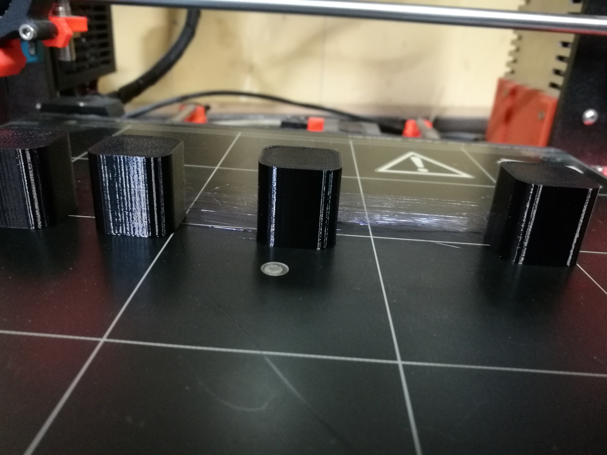

Well, here's a 4-cube destring wizard. Note that the preload has been set according to "experimental" and then fine-tuned with "Wizard". Cube height is 20mm and destring parameters are 0 to 4. Best height is about 9.4mm, so I will now use a destring value of 2mm for this filament. The stringing is consistent between the cubes, irrespective of distance.
