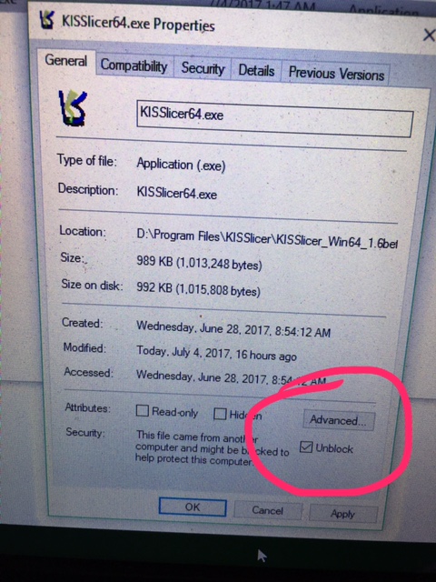

Jonathan, thanks a million for the new release. I downloaded the Windows 64 bit version, but for some reason it won't open on my computer. I changed the security settings to allow "All" to use the program to no avail. Previous versions worked fine when I did this. Any ideas?
Re: KISSlicer 1.6 Beta 1.1 is here!
Wow, I set all the security settings I could find to "Allow" and even tried different administrator signons and nothing would allow me to open the new 1.6 Beta 1.1. Then I noticed this little check box at the bottom of the properties screen...dohhh!!!
Working fine now :)
Edit: Windows should have put this checkbox in the Security tab where I would have spotted it right away when troubleshooting the issue. It makes no sense to put it in the General tab.
