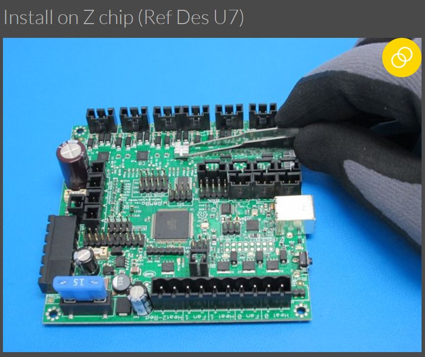

Z Chip overheating is a known issue with the Lulzbot TAZ 4. On the TAZ 5 they started installing a heat sink on the Z Chip to mitigate the issue as shown in the following pic; however I added a bunch of wires to convert the TAZ 4 to the TAZ 6 so the heat sink by itself doesn't do the trick anymore.
Heat Sink On Z Chip.JPG (96.74 KiB) Viewed 5602 times

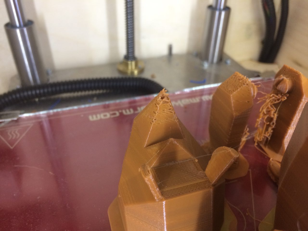

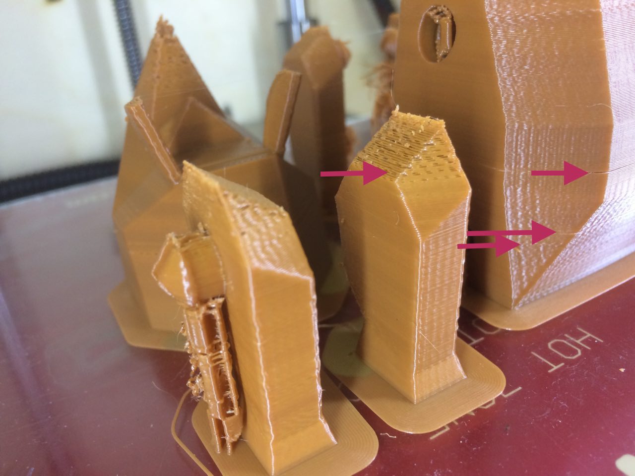

Very strange bug with Preload (I think):
preload calibrated, model printed very well at bottom and middle, but very poor on top, see pics:
stl models -> https://drive.google.com/file/d/0B8dro0 ... sp=sharing
settings attached
settings.zip
(6.01 KiB) Downloaded 247 times
mhackney
Posts: 147
Joined: 25 Jan 2015, 10:48
Post by mhackney »
That looks like typical filament starvation to me.
That's a lot more common with PLA than ABS though. Nothing in your settings jumps out at me, temps seem reasonable, retract distance and speed are reasonable. Perhaps check your extruder to make sure the drive gear is firmly secured and clean (no plastic residue) and tensioned properly. This just doesn't seem like a bug to me.
