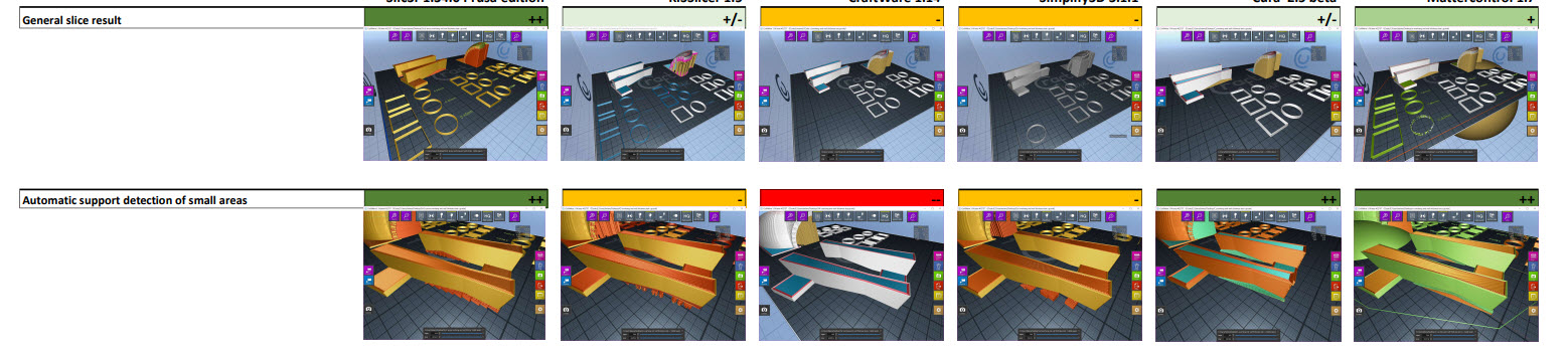

Look at all the shape of your part in all direction (X and Y), you will see that shape angle are too small for being supported without a lower support angle setting (zero).[/quote]
Can be, can be! But in real live it needs a support structure.
I don't know how other slicers get it done, but of the 6 slicers I tested there were 3 that were able to recognize that extreme overhang and generate support.
Test spreadsheet here:
https://www.craftbot.nl/2017/04/04/new- ... comparing/

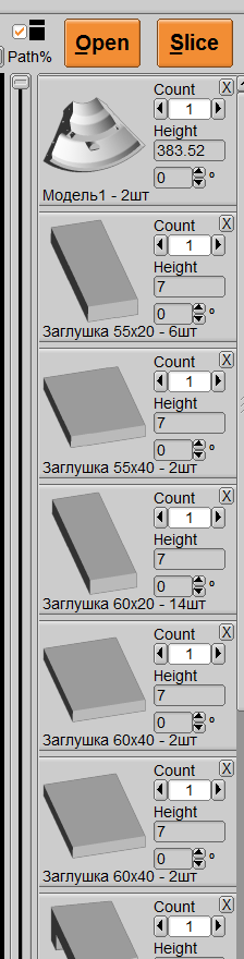

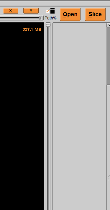

Hi. If you fill the list on the left with fully models, it stops displaying. We must rise to the beginning.
- 2017-07-12_13-28-00.png (8.31 KiB) Viewed 6819 times
- 2017-07-12_13-28-14.png (24.83 KiB) Viewed 6819 times
