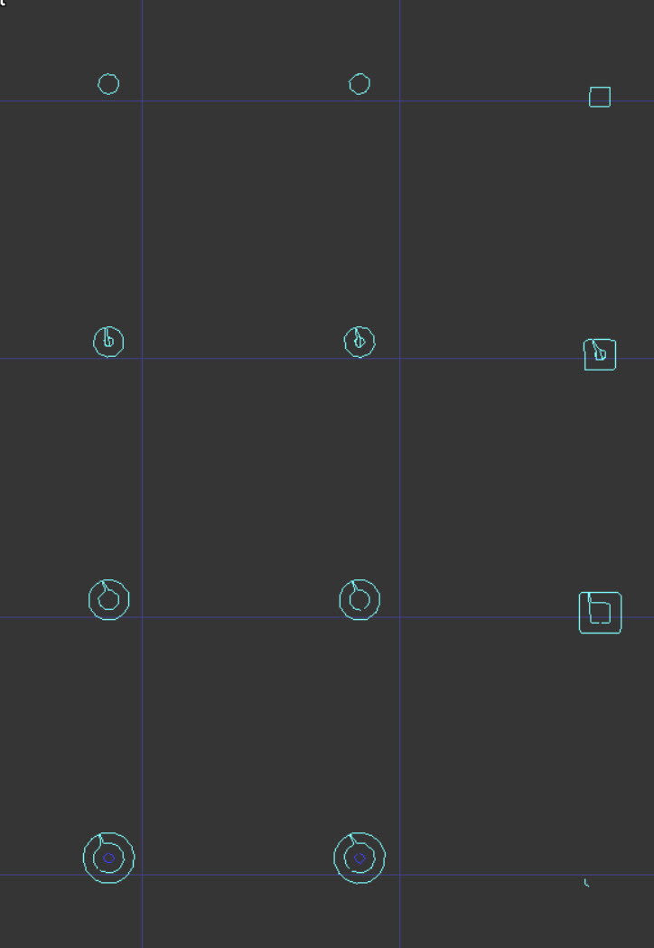

Regarding the new "Join Loop" box I don't understand the remark that
the gap optimal has to be zero
(when some dark side feature tweaked).
As with zero, the paths (the middle of the extrusion) are just kissing each other. But with for example 0.4mm pathwidth, than it's resulting in a double amount filament at that overlap. That can't be good I think. The advance feature is only compensating for the delay of response of the extruder regarding the (de)acceleration of the XY movement. That has nothing to do with that seam (overlap) IMO.
Also: are the values of the seam settings in mm or percentage. It seems in mm. The % would be preferable when changing the extrusion width.
funBart wrote:I checked the new seam future: Join-Loop. It seems to me a very good idea to have a non hard stop at the seam, but in stead let the path of the loop fluently connect to the perimeter.
No Join Loop:
Seam: a part of the outer loop path is combined with the perimeter path
Full: the complete outer loop path is combined with the perimeter path.
I have to check still how it works in real life. That's hard as the effect is also depending to the new "advance" Preload function I don't understand yet..... Where to begin?

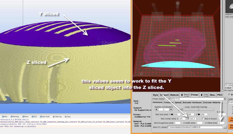

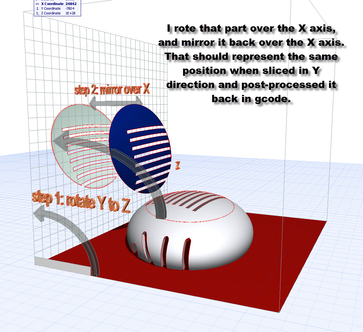

wait for the 2.0 track.
Sure, sure, that good old future feature release ;-)
Can I assume that my infamous "Y is the new Z" function will be in that release as well?
https://www.craftbot.nl/2015/07/08/y-is ... direction/
That's a way to complex sequence to be able to print slow slopes smoothly by slicing in Y direction in stead of Z.
Although that function is way more complex when there are different levels of slow slopes.... But than again: you are the first implementing the automatic variable layer height. It's peanuts for you!
