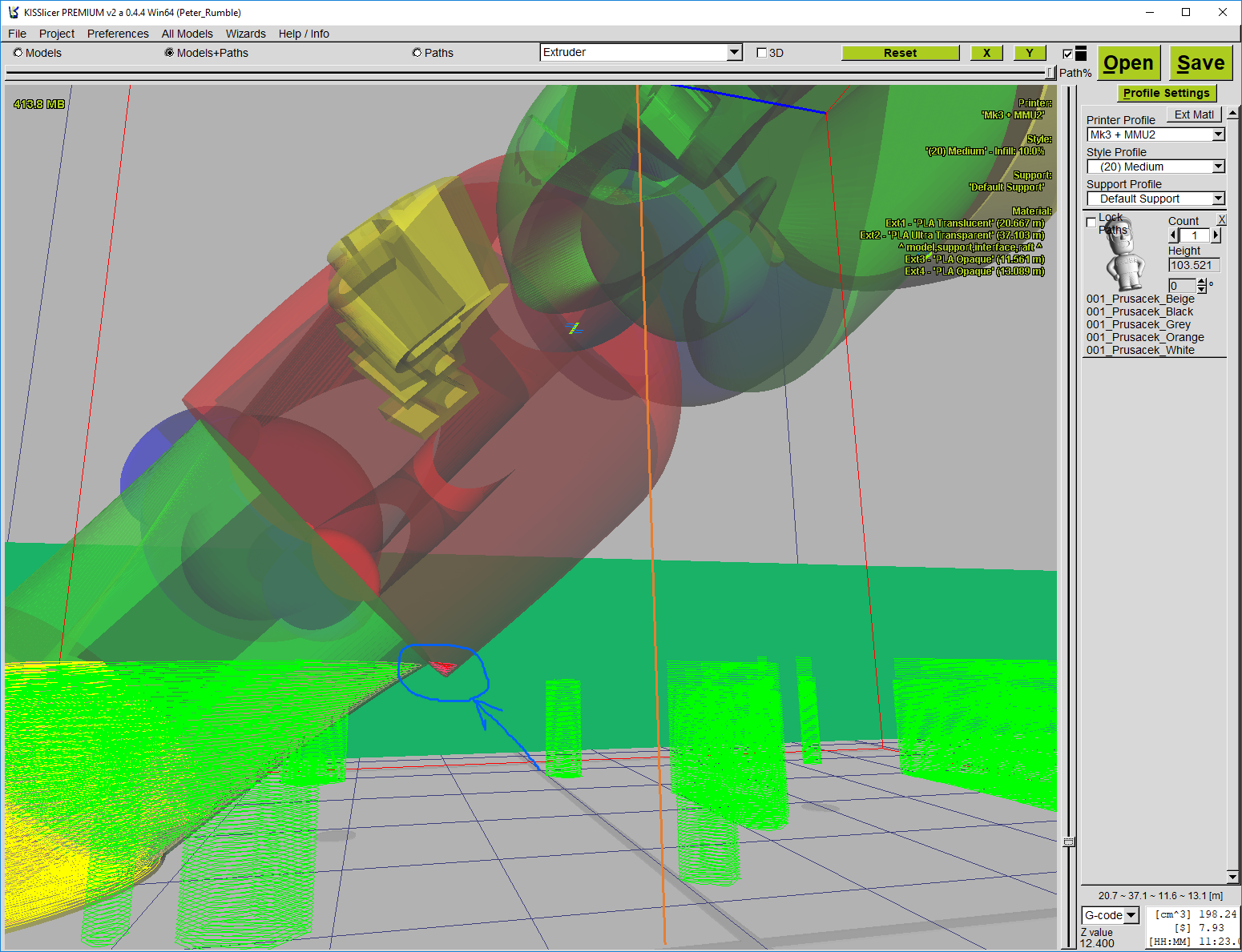

Support detection/generation failure:
Printing in mid-air does not work!

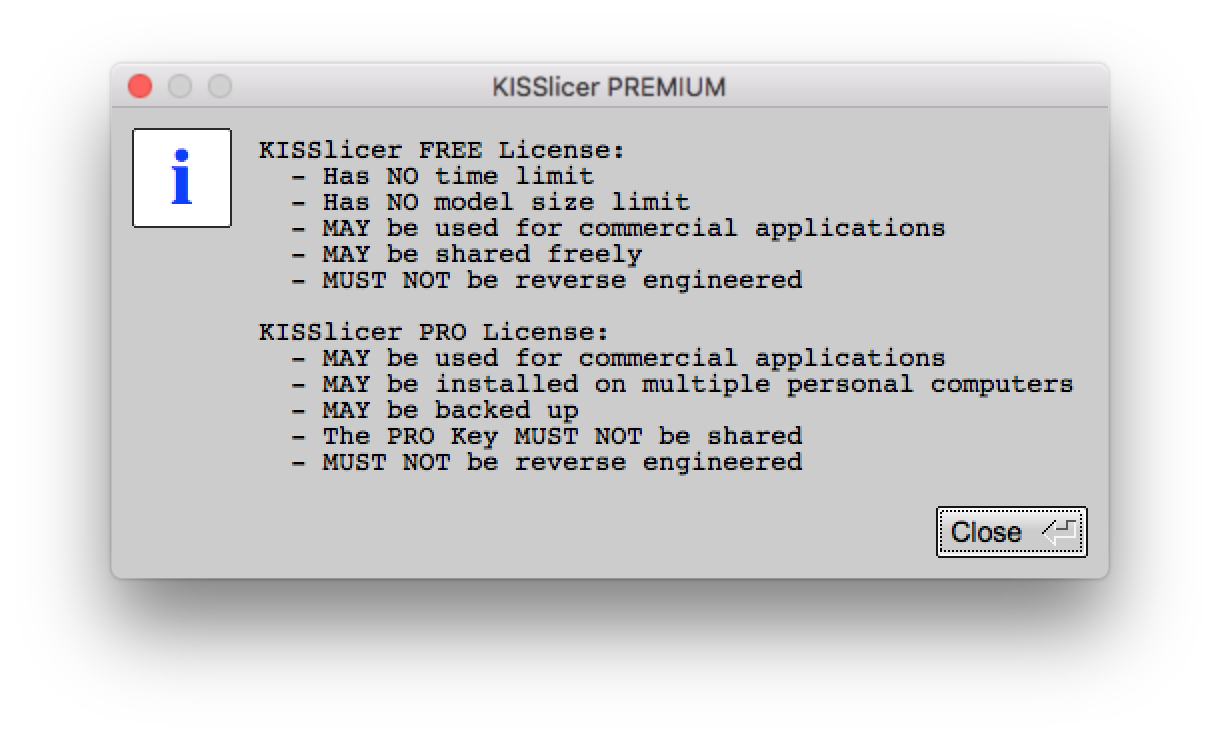

Yesterday I had a sudden urge to upgrade to the premium license (for no good reason) and found a horrible UI shortcoming.
it does show that the license is premium, but doesn't mention it in the writeup! Monstrous!
More seriously, I went to that window first trying to find where to enter the product key, I fully expected that I can get there from "license" dialog, maybe a button there and/or about box would be a nice idea. It's not quite natural to look in the "file" menu, especially on mac, where it's not really the very very first menu.
Obviously, this is not a priority item, if one has bought a license he will find a way to enter product key eventually ;-)
