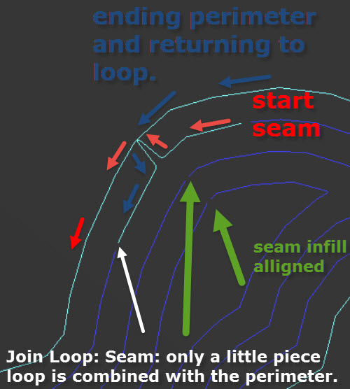

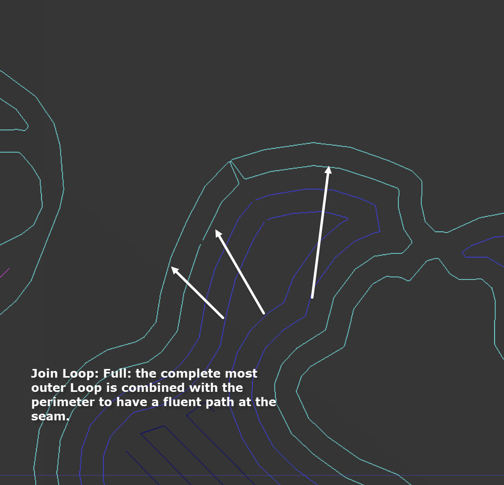

I checked the new seam future: Join-Loop. It seems to me a very good idea to have a non hard stop at the seam, but in stead let the path of the loop fluently connect to the perimeter.
No Join Loop: Seam: a part of the outer loop path is combined with the perimeter path
Full: the complete outer loop path is combined with the perimeter path.
I have to check still how it works in real life. That's hard as the effect is also depending to the new "advance" Preload function I don't understand yet..... Where to begin?
