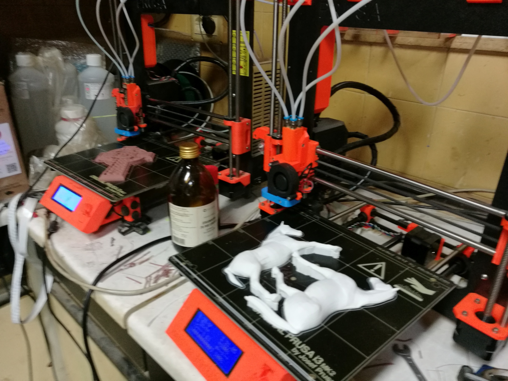

Here are the printers:
(sorry for the poor picture quality)
Both Prusa i3 "Originals" Mk2/Mk2S with MMU. Basically 2 "identical" printers (E3D V6), one can print Copperfill the other can't.

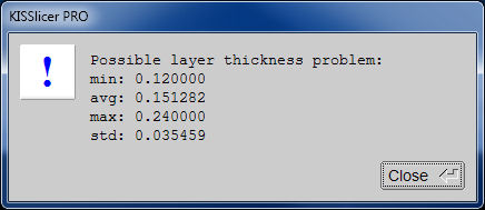

Using your profile settings, I sliced with 1.6 RC2.2 (not yet on general release)
Before slicing:
Closed the warning and sliced the file. The preloads are now quite different and there are no instances of F0 - all the preload speeds appear to be correct.
I think Jonathan will be releasing an update shortly which should fix your issue, but in the meantime, the work-around is to edit the GCODE file and replace all instances of F0 with F500.

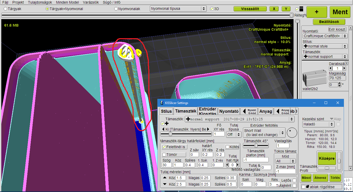

on picture: Unwanted support in the corner.
not on picture: No path color key for pale fuchsia and faded pale fuchsia.
Minor issue - Parameter-Specific Help text box in the Tuning Wizard Configuration window does not scroll to see all text.
It seems that some release notes items deal with mac text overlay problem, but as far as I can tell it's not fixed.
