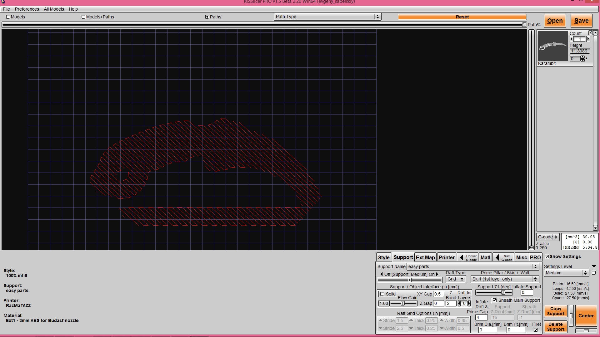

kisslicer produces such raft:
also there is strange wall on level #3

Wasn't repaired enough or competently. Lots of cruft on the flat cut poly that should have been eliminated. Shouldn't be trying to produce a raft anyway. There's enough surface area that a raft is redundant. Producing a raft, that then would require support to hold all of the overhangs, would seriously impact the model surface quality on the under side. The model is already sliced down the center for printing two halves without raft or support. For whatever dumb reason, Cut_1 isn't flipped to place the flat on the bed. Easy enough to flip it with the Transform Mesh menu.Shaeto wrote:kisslicer produces such raft:

okay, may be karambit model is not very good example

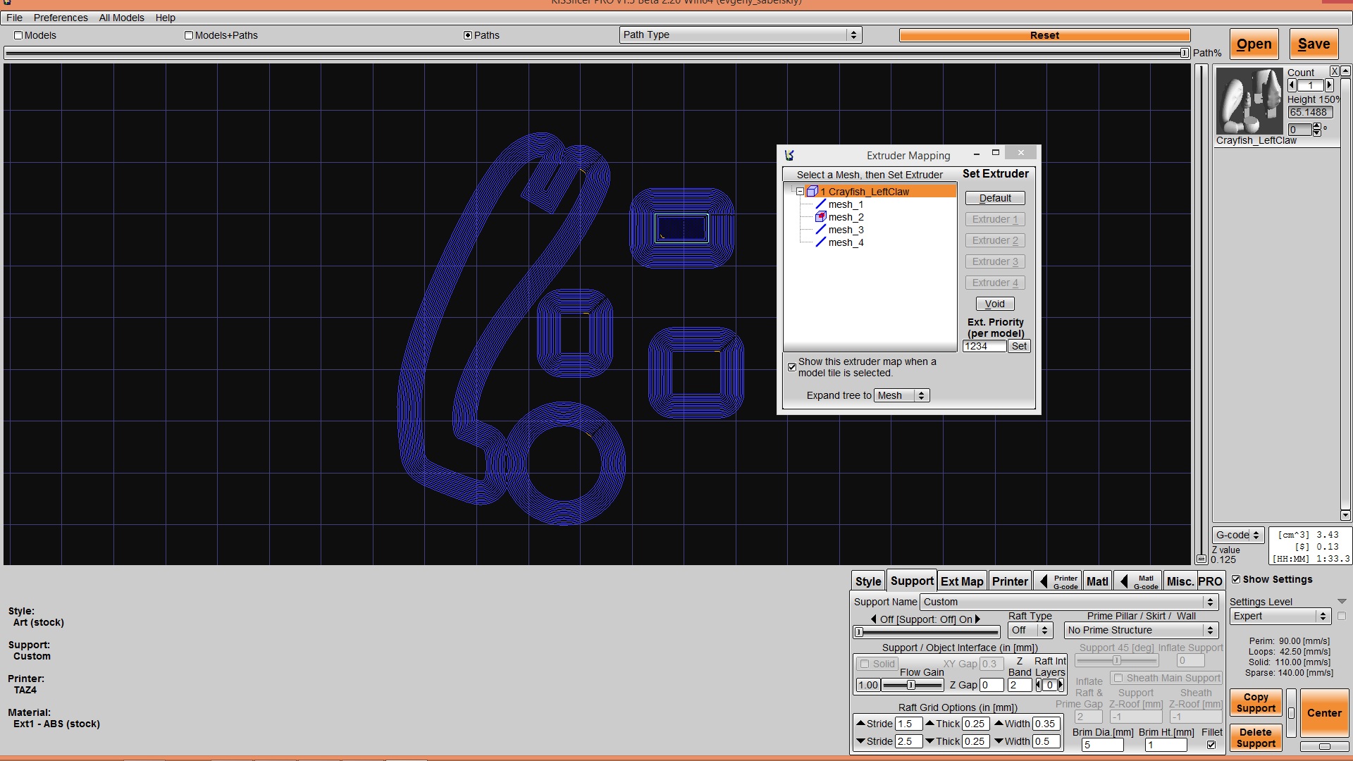

next issue: Kisslicer 2.20 does not exclude mesh from support/brim algorithms when mesh is set to Void in Extruder Mapping window

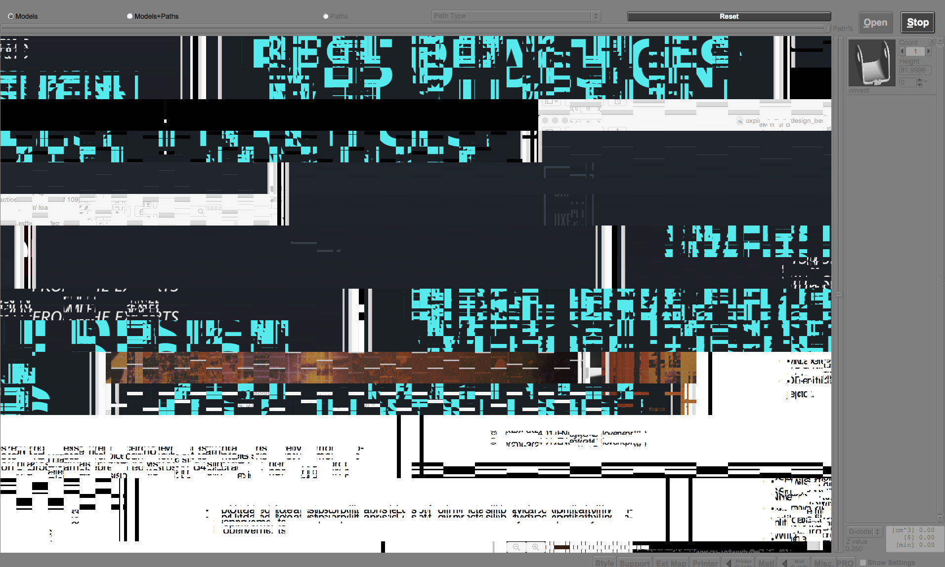

And, a job just came through and now I am experiencing the mac video bug. I get this flashing on and off during slicing. and when I bring a model in, I can't see it on the screen. ugh.
Update: tried re-starting. tried using an older version. all do not work. I am switching to Slic3r now because I have to get this job done. I will check back here over the years to see how Kisslicer is doing. too bad it's fallen to the wayside. it was a good slicer.
