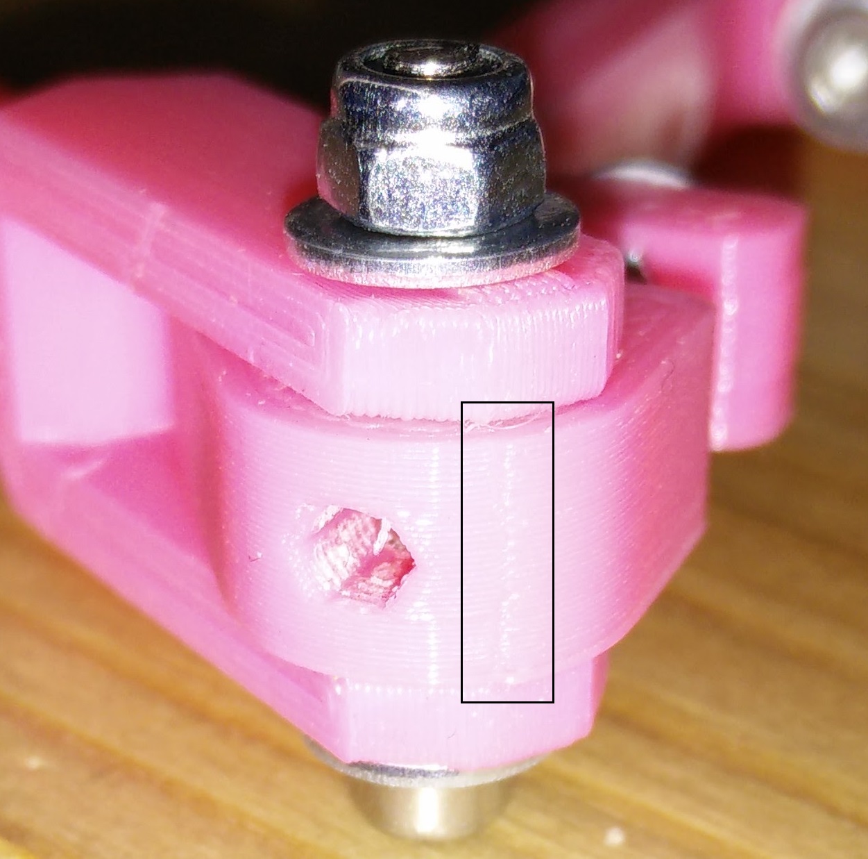

Material : PLA E-sun
Hot End : E3D V6 0.4mm with 0.45mm in Kisslicer extrusion width parameter
Layer : 0.2mm
Print Temp : 220°
Medium speed print (~30mm/s)
Seam Hiding.jpg (14.55 KiB) Viewed 5139 times
Re: Seam hiding
Looks great. Do you use bowden or direct drive extruder? If bowden, how long are the PTFE tubes and did you have strings?

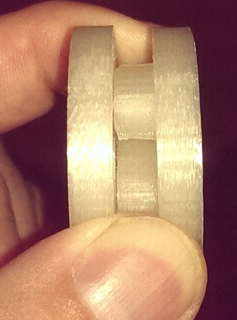

a picture of what I'm getting ATM (just slightly under extruded at path start)... the seam is just above the flash highlight
PLA natural .2mm layer height
S-plug-PLA 2mm layer.jpg (76.69 KiB) Viewed 5055 times
If you want settings/more pictures etc... let me know.
