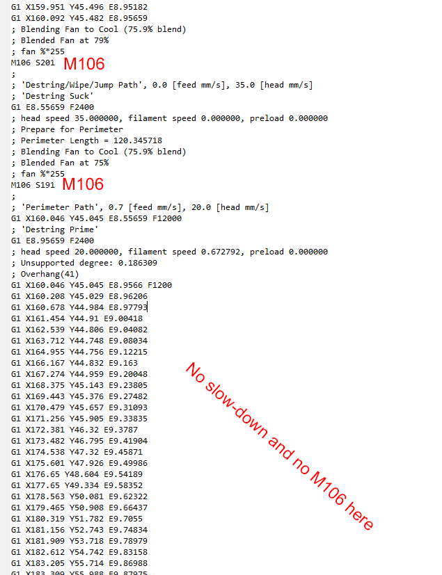

I made some tests and screenshots...
Perimeters: 1.8 m³/s
Cool: 1.8 m³/s
There is NO Slow-down and NO M106 during the Perimeter.

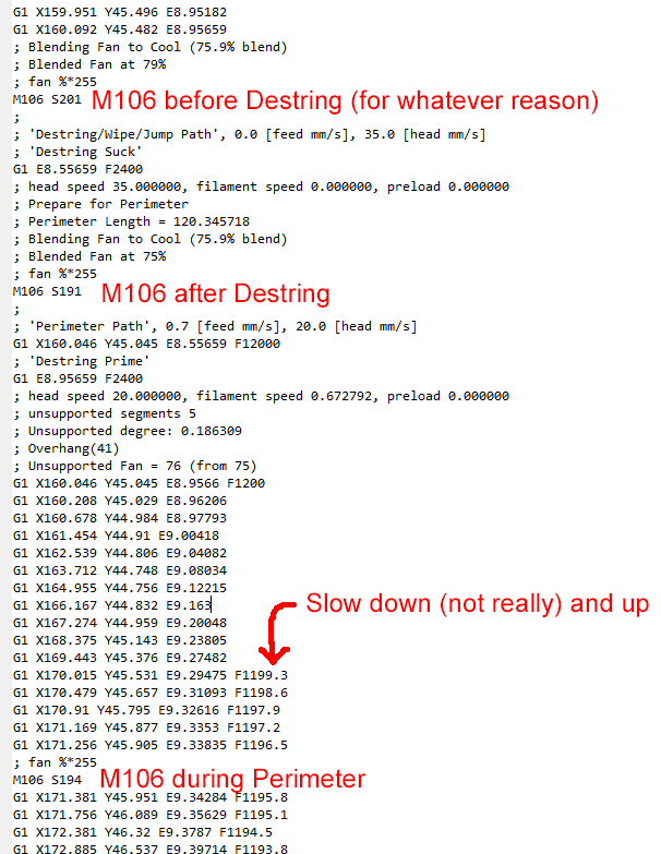

Here is set the Cool Parameter to the value 1.7 m³/s:
Perimeter: 1.8 m³/s
Cool: 1.7 m³/s

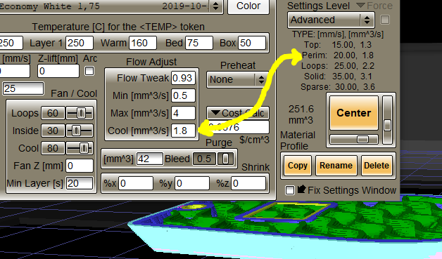

I figured out some logic behind the overhang-feature:
The Cool-Flow-Setting has absolutely no effect on the printing speed of overhangs. The Cool-Flow setting has only effect on the fan-speed (M106-Command) at the overhang, and the max fan-speed for the overhang is dependent on the Loops-Fan-Speed setting.
The only setting which unfluences the overhang speed is the "Min Layer [s]" parameter...also it influences the slow-down and speed-up behaviour. Ok, but the min layer time parameter influences the overall speed. So this is no option.
There is another crazy behave...the Cooling-Fan-Speed for the overhangs is always lower than the normal Perimeter-Fan-Speed :?
So if you set the fan for loops to 60%, the overhang never has a fan of 60%...the fan is 10%, or 30% (dependent on Cool-Flow-Parameter).
...But especially a overhang needs more fan than a normal perimeter.
At the moment I can use this for workaround:
Setting Cool-Flow to a very high value (e.g. 100 m³/s) and set the the Loops-Fan to a good value for overhangs (e.g. 60%). So you have for Loops, Perimeters AND Overhangs the same fan-speed (in this case 60%) but also the same print-speed.
-> The Overhangfeature is quasi deactivated.
It would be nice for updates in future, that the Overhang-Speed is able to goes down to the Min-Flow-Setting. In my view the overhang feature isn't working right.
Whether you set a loop-fan of 5% or a loop-fan of 80%...the overhang will not be printed slower or faster (the Cool mm³/s parameter is not working right).
