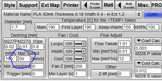

into material tab set max speed to 50 :

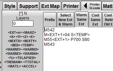

into PrinerG-code / Warm same extr put this :

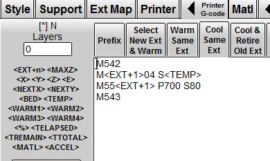

INto printer g-code cool same extr put this:
