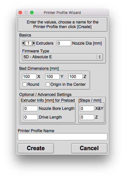

Printer Wizard - 12 parameters (plus a name for the profile)

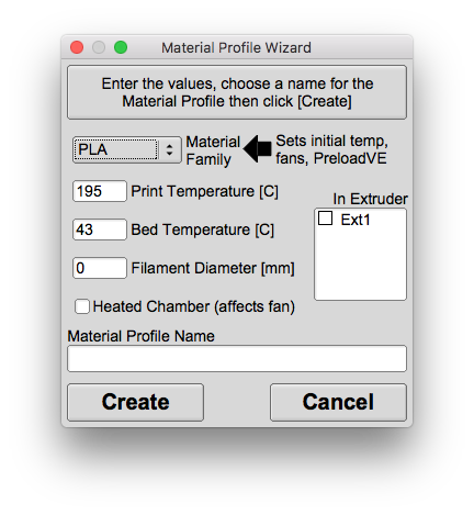

Material Wizard - 6 parameters (plus a name for the profile)

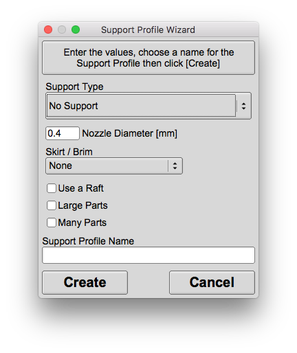

Support Profile (optional if you don't use supports or you can add it later) - 6 parameters (plus a name for the profile)

Printer Wizard
  • Extruders is easy and you should know that.
  • Nozzle Diameter should be easy as printer and hot end makers tell you the nozzle size.
  • Firmware Type two of the options name the printer type. If you don't have one of those two, then either 5D - Absolute E or 5D - Relative E will most likely work just fine with most open source firmware. I recommend choosing relative E.
  • Bed dimensions - really only help KISS make sure your model is printable on the bed. Even a rough measurement will get you started. Printer makers will tell you this.
  • Do you have a delta printer? If so, check the Round and the Origin in the Center boxes.
  • Optional/Advanced Settings are, well, optional so leave them set to 0
Net result: you should be able to complete this in 1 minute.
Material Wizard
  • Material Family - select your type of material here. Easy
  • Print Temperature will be set to a reasonable default, leave it alone if you are just starting.
  • Bed Temperature is probably the most difficult setting of all of the wizards since it depends on what type of print surface you are using. Seek professional help here or one of the many forums.
  • In Extruder - if you are using the free version, this is easy as there is only one option, click it.
  • Filament Diameter is either 1.75mm or 2.85mm. Is your filament thin like spaghetti? Then 1.75mm is it
  • Heated Chamber - you should know this
Net result: you should be able to complete this in 1 minute. If you don't know bed temperature either ask or leave it at the default value and test.

Support Wizard
Completly optional but let's go for it...
  • Support Type - pick either No Support or Same Material as Object if you are just getting started.
  • Nozzle Diameter - has been answered twice already and that value will be preset here.
  • Skirt/Brim None, Skirt or Brim. If you are just starting and don't know what these mean, select Skirt.
  • Use a Raft leave unchecked if you are getting started.
  • Large Parts leave unchecked if you are getting started.
  • Many Parts leave unchecked if you are getting started.
Net result: 30 seconds to complete.
