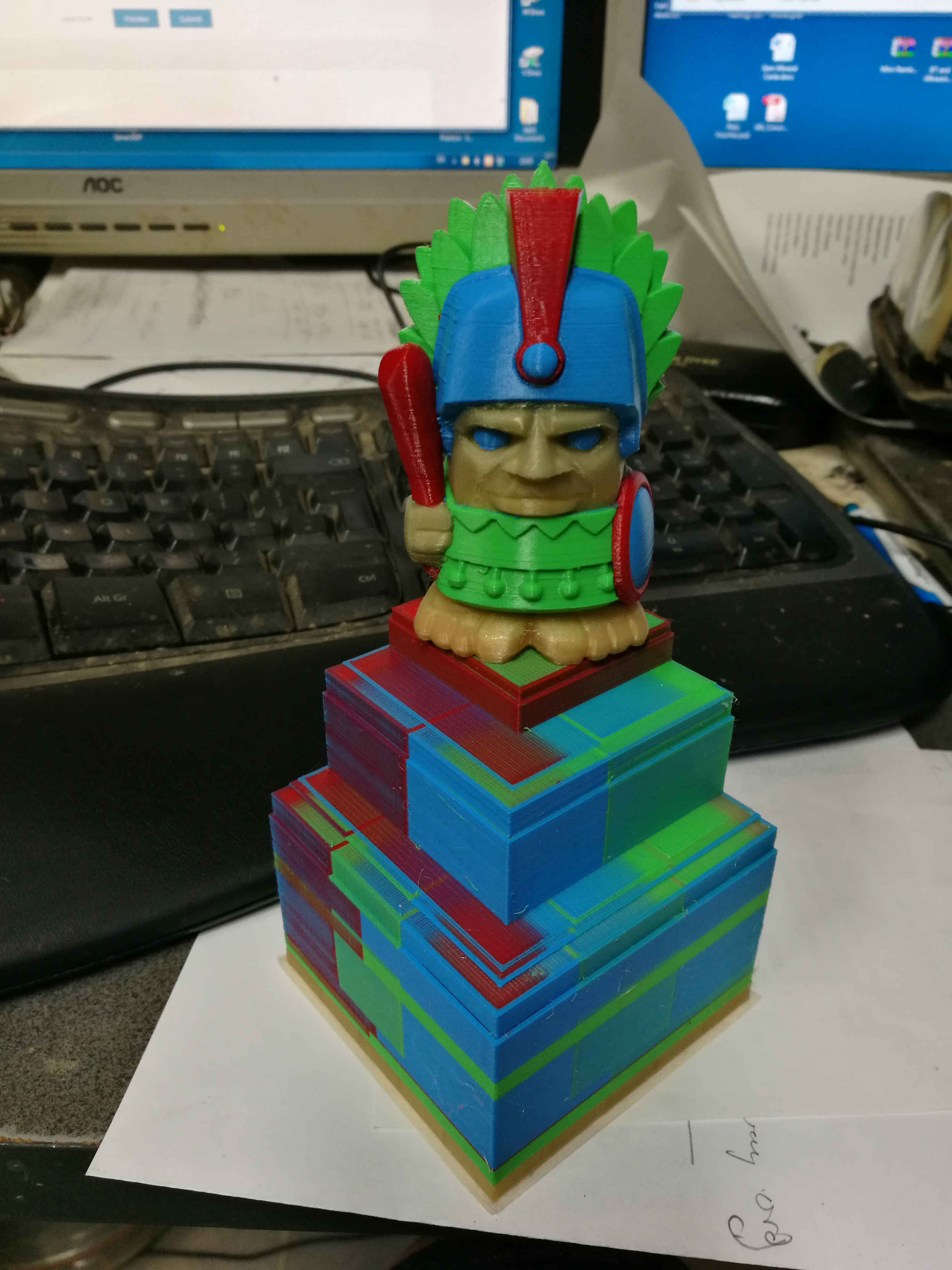

4 colour variable layer height, variable purge standing on the purge tower:

Looks great, Peter!
Which hotends do you use?
Eddy
Re: KISS 1.6 Beta 3.10
EddyMI3D wrote:Looks great, Peter!
Eddy
Just one (SNMM), hence the relatively huge purge tower. E3D V6. But with modified heat break and special PTFE liner (1.9mm ID).
Biggest issue is that with 0.1mm layers, you still have to purge the same amount of filament on each change as 0.3mm layers.
Post by Olivier13 »
Wow !
The result is very amazing.
Is it a "make it sure" purge tower or have you calculated/designed it before the print?
http://www.additec.fr
Olivier13 wrote:Wow !
With SNMM you have to purge a lot of material. With all post-processors (and Slic3r PE) until now, you basically entered the tower size and it created a simple purge tower with all filaments having an equal purge area.
Of course, opaque filaments require less purging than translucent/transparent ones, so I wrote a post-processor which does exactly that. The purge amount can be determined either by extruder or filament name. Now I purge 30mm for opaque filaments, 60mm for translucent, 80 for transparent etc.
The result is a smaller tower and less overall filament waste. :D

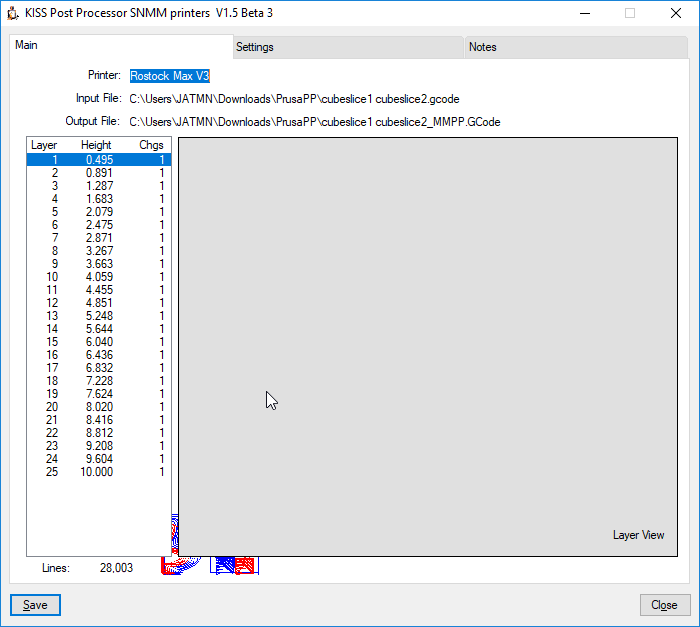

Joined: 23 Sep 2017, 19:41
Post by JAT.MN »
It does not like round beds I think.. see screenshot.. I had tried this before posting :(
JAT.MN wrote:It does not like round beds I think.. see screenshot.. I had tried this before posting :(
Shouldn't be too difficult to fix. Will have a look. The only issue may be the physical size so it may need to be scaled a little.
