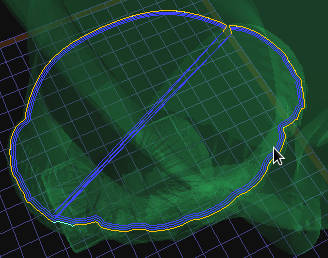

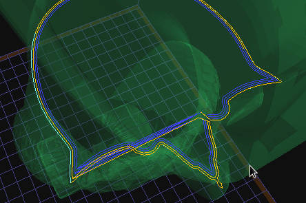

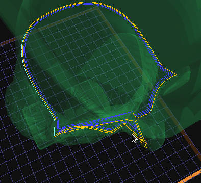

i really like KISSlicer, and use it very often. But when slicing an owl model (from Thingiverse, https://www.thingiverse.com/thing:693371 ) in the original size, i get some slicing errors. The errors are visible on some layers, but mostly invisible when printing the model, cause they are in the inside.
But at the face of the owl, there is a concave form, and the errors are visible. I first thought it was some nozzle oozing, but found the lines are inside the gcode-file.
This is one visible slicing-error
An other visible slicing-error
This slicing-error is invisible after printing cause its inside the model

1. Upgrade to the latest version of KISS which is a little more tolerant with errors in the model.
2. The model is not good. You should attempt to repair it with NetFabb or similar (Win10 3D builder is apparently a good repair tool).
Many slicers attempt to fix or simply ignore errors of this nature. KISS at least allows you to see the model errors (open "Mesh Error Window") so that you have the opportu=nity to properly fix them.

KS 1.5 Win64 and 1.6 Win64 flags the model with errors. The model has 12 overlapping/intersecting faces. Detected by running the model through 3DS Max and using the error checking tools it has.
That is what causes path errors like that, been manually repairing that problem on models for years.
I have yet to see an application correctly repair these small face errors.
