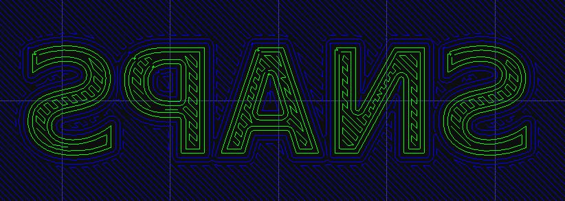

1. I'd like to add changing the number of Loops. Here's why, I like to have about 3 Loops for my perimeters except on the few layers where I'm printing text. It seems KISSlicer is better able to consistently fill in text letters when the number of loops = 1 so that will be my default go-to value for printing text layers
Pic 1 Number of Loops = 1 - Nice Text Fill Whereas when the number of loops > 1 I can get poor results sometimes.

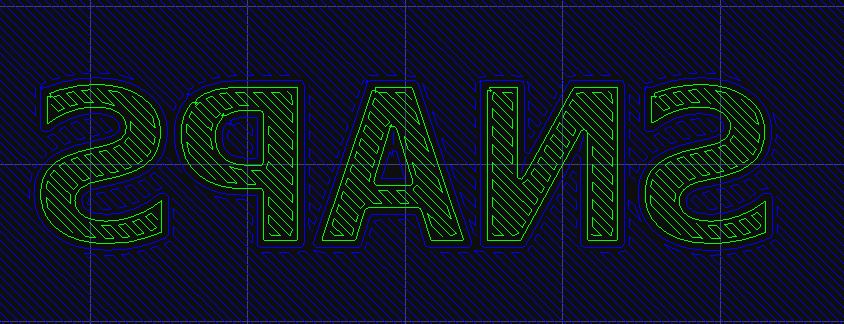

Pic 2 Number of Loops = 2 - Poor Text Fill Letter's S and P 1. Trigger by height or layer number

Yeah, the list looks OK, but there's no way of changing the number of perimeters within a post-processor - that really is a slicer function.
