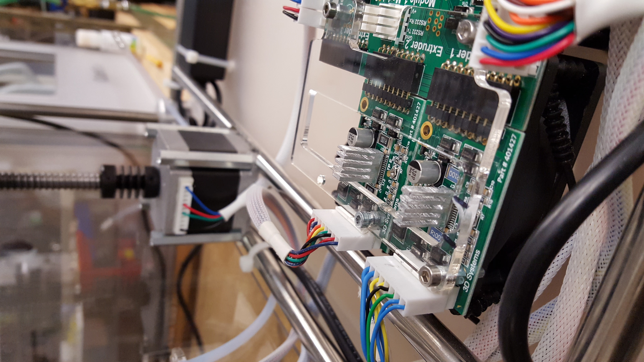

Giovanni, do you think this heat sink will do the job? I set the voltage at 1.65 using cubex hotends.
Re: What controls RPM??
joestefano wrote:Giovanni, do you think this heat sink will do the job? I set the voltage at 1.65 using cubex hotends.
Yes, but you can also cut them a little larger than the chip and you can bend the blades to increase the air flow between them.
