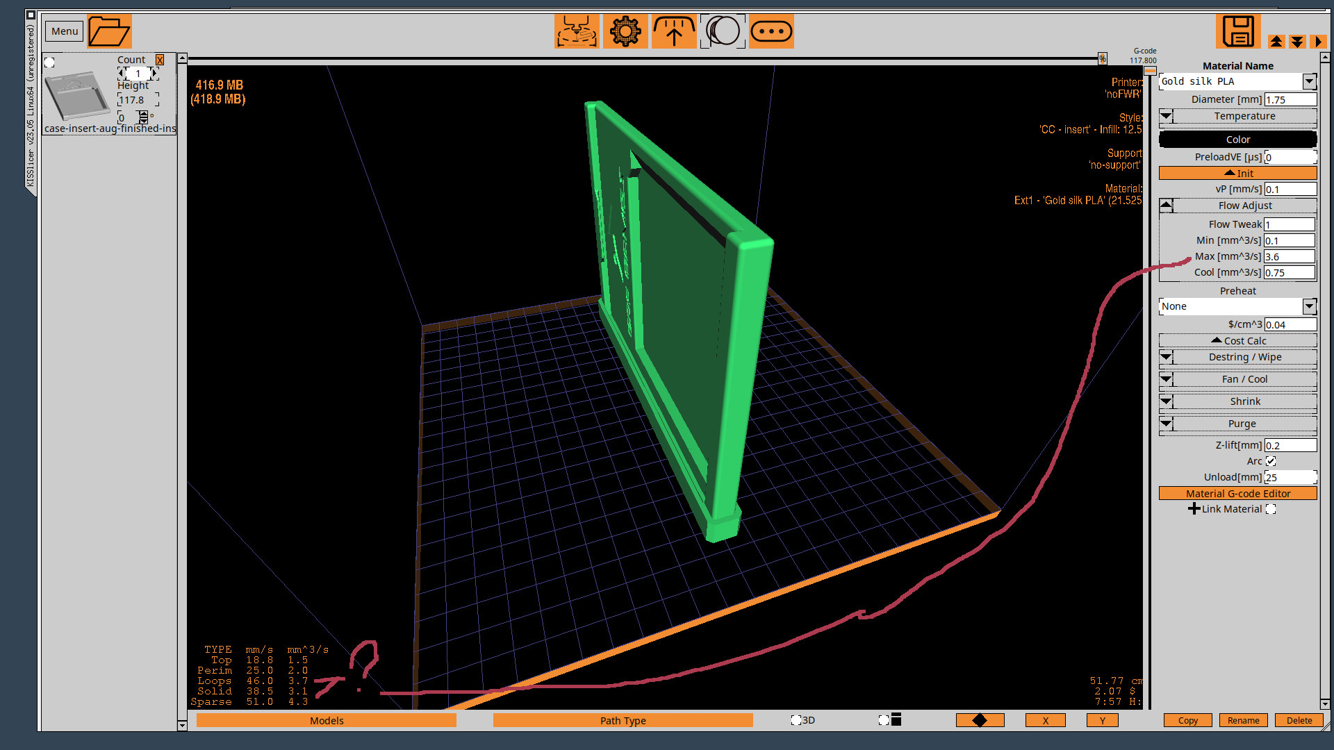

I understand correctly that MAX should limit the Flow used?
Re: Max flow is ignored?
The figures in the bottom left are the volumes according to printer/speeds and style/improve quality.
They will be limited in the G-code by the filament max volume.

I see. Thank you.

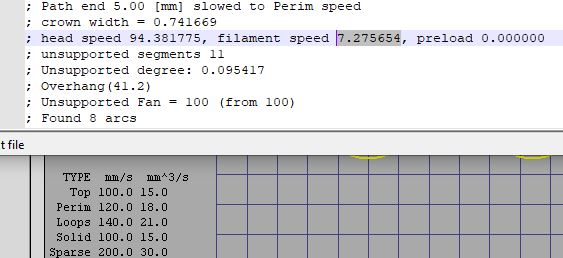

In the G-code, at the start of each path, you will see something highlighted similar to this pic:
The material max flow in this situation is 17.5 mm^3, hence the reduced head/filament speeds.
