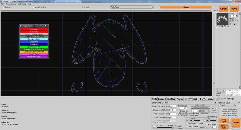

Hi Everybody,
Kisslicer Version : 1.5 Beta 16 Win 64
Layerthinkness : 0.1mm
I find a stange loop path at Z 3.1 to 6.4 when i slice this model : http://www.thingiverse.com/thing:18479/#instructions.
Does it come from the model or the slicer ?
I can provide more information on request.
Strange Loop path
- Posts: 133
- Joined: 17 Nov 2014, 09:20
Re: Strange Loop path
self intersecting faces in the model, and holes in the mesh
- PenskeGuy
- Posts: 98
- Joined: 08 Nov 2014, 18:04
Yep. We really do need a Sticky on [insert whatever may be appropriate here] downloaded from Thingiverse and why it most probably is Borked because people don't know how to model stuff. Yes, I know that slicer X does it just fine. Irrelevant to the actual issue at hand, because the other slicer isn't smart enough to even know that there is a problem with the mesh.
