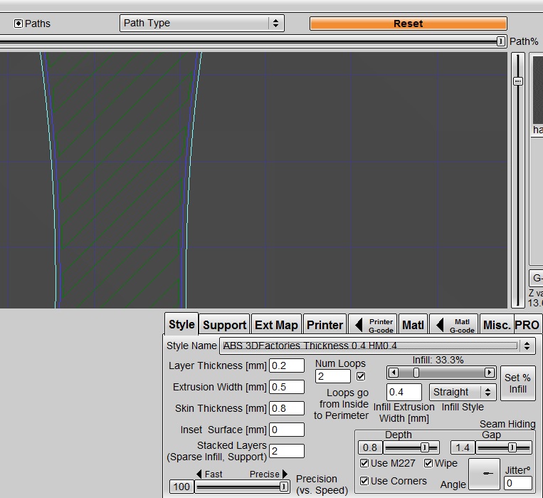

I don't have this problem, set "Path type" instead of Materials to show what kind of path is causing the problem.
M227 will affect the print but not the slice.
rantzaus wrote:Hi again
I tried to change the skin thickness to 0.8mm. It didnt change the outcom, se picture...
i also tweaked the M227P to 0.08
I also loaded the language file again...

I tried to set the infill % to 33, like in your try, and the zig-zag dissapeared.
I was only using 12.5% infill...
Is there a golden rule, not to use less? Or is it something I have to try doing different parts?
Re: CubeX path problems
unfortunately no golden rules, it depends on the shape of the part.
The path that is causing the problem is the "Sparse Infill".
I've tested with 12,5% Infill and skin 0.6mm and 0.4mm the zig zag also desappeared.
Anyway, you found a solution for the zig zag but I'm not sure the blobs on the sides are produced by this problem, did you run a calibration cylinder with 1 loop only ?

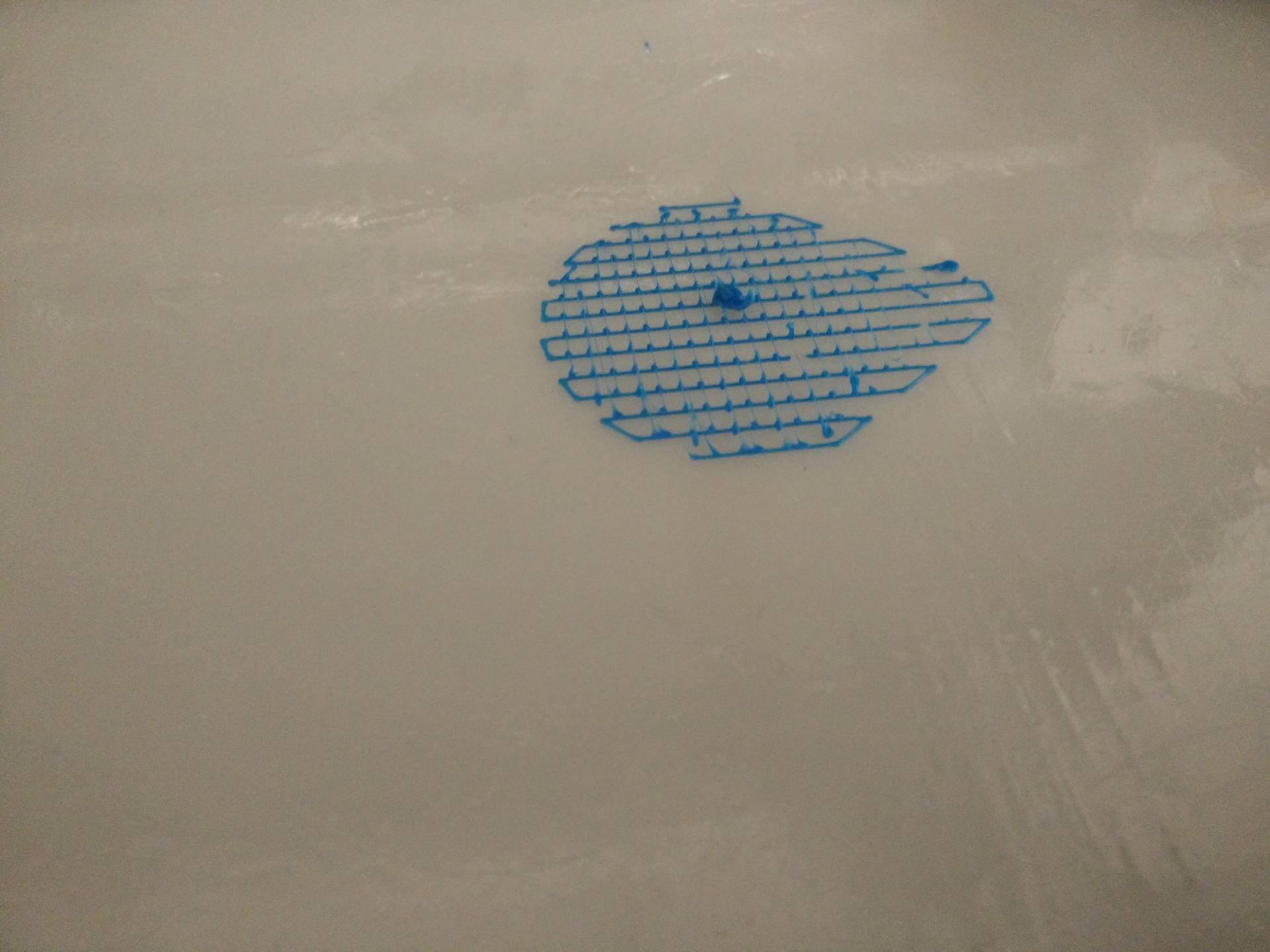

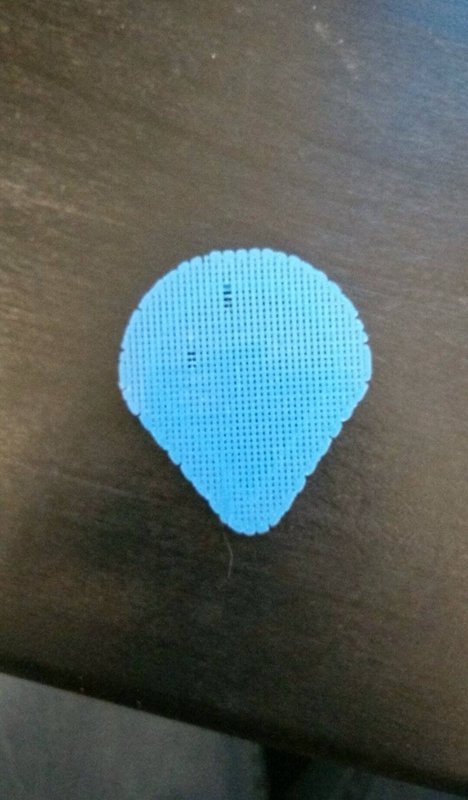

In my old version of the kisslicer, 1.4.5.10 i followed the cubexupgrade tutorial on how to calibrate. I just did the same with the 1.5 beta 2.22, and the raft was rubbish. its like the second layer isnt a full string, but only small dots. se picture.
that was not a problem in the old version.
raft from old version
raft from new version
I forgot to add the raft feature to CubeItMod6 calculations.
I'll post the fix soon.

rantzaus wrote:Hi Again
Thanks for the reply.
