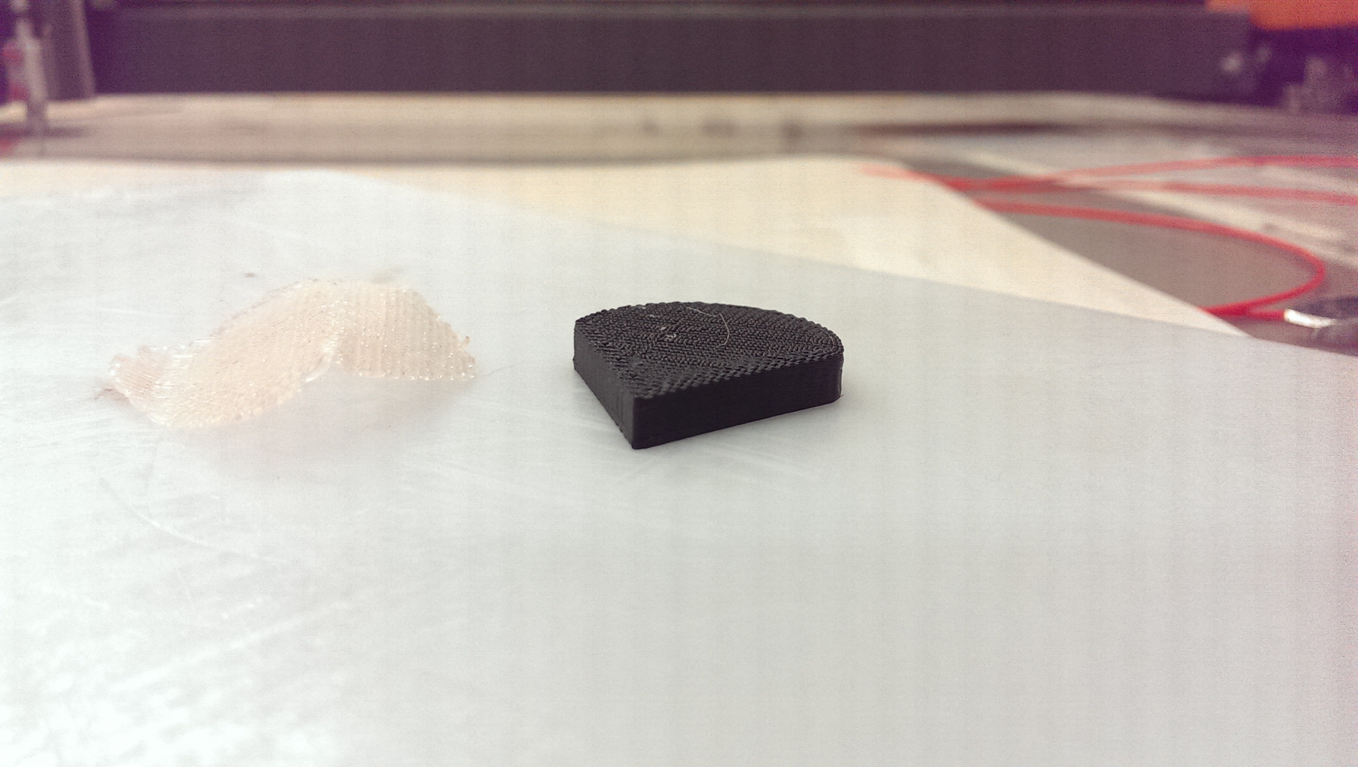

I'm a bit confused at the filament error. If I remember correctly if you get through the init sequence fine then it moves to print position and does nothing or filament error. M108, M227/M228 are the causes I've run into. Do you have your Printer(main tab) + Firmware (sub tab) + Firmware type(drop down) = bits from bytes printers?
Okay, so I may have found one spot where people were having trouble with my settings. Kisslicer builds are changing M words based on the extruder# throughout the program (i.e. M108 to M208) when its set up for multi extruder.
I had been using KSS on single extruder and a notepad++ macro to change the M word sets to get it to run (something that Cubit fixes, but also adds the lightspeed bug - i have not tried 'safemode' yet) I didn't realize it was doing this and I did get it setup KSS setup for multi extruder on monday and it suddenly stopped extruding. Mine will go through the init just fine, purge/wipe correctly, but when it starts to build it would not extrude, just go through all the motions as if it were printing air(actually runs whole program without extruding). so find&replace M208 with M108 and its back to running.
Another issue is I've left the header alone but EVERY program start I get two messages @ program load
"verifying file"-I assume the printer is checking the header
and
"Processing file"- if it has the header (^Firmware:V1.00 ... etc) the rest of it ... that I currently have deleted- is irrelevant
it still homes at program start,
still parks and waits for 'glue'
still 'heats the chamber' (I just read the status on the screen, I don't think I physically checked for heat from the space heater... i'll make a note to do this)
-beyond that I did not change extruder select Gcode (same one I posted on 02/09)
Postfix is also irrelevant(currently empty)- at program end machine terminates all heat(i have physically checked for this), shows summary screen, and parks plate at max +z.
Let me know what you guys are trying/running into.

The cubepro accepts the code, heats the chamber and then starts the print but remains on the "heating chamber" screen. Then it does a weird 3-dimensional move that has the head traveling in the x and y axis while dropping the z an inch or so. Clearly this is not what I'm asking the machine to do so I have no idea what is going on with this encoding.
1. BFB from KS
2. Add header from cubepro.exe file
3. Encode with codex
4. ...
5. Machine goes bananas.

I think thats exactly what mine started doing.
finally managed to get it accept a print, but it would make contact to the board and lay a "point" of material, then random move to another point while the Z axis slowly moved down, then met up again a bit later.
Like you, the screen stayed on the heating chamber screen.
My machine is on 1.10A of the firmware though, what about yours?
This was from KS (2013 version) cubeitmod (safemode) and then CUbeX decode (single extruder)
