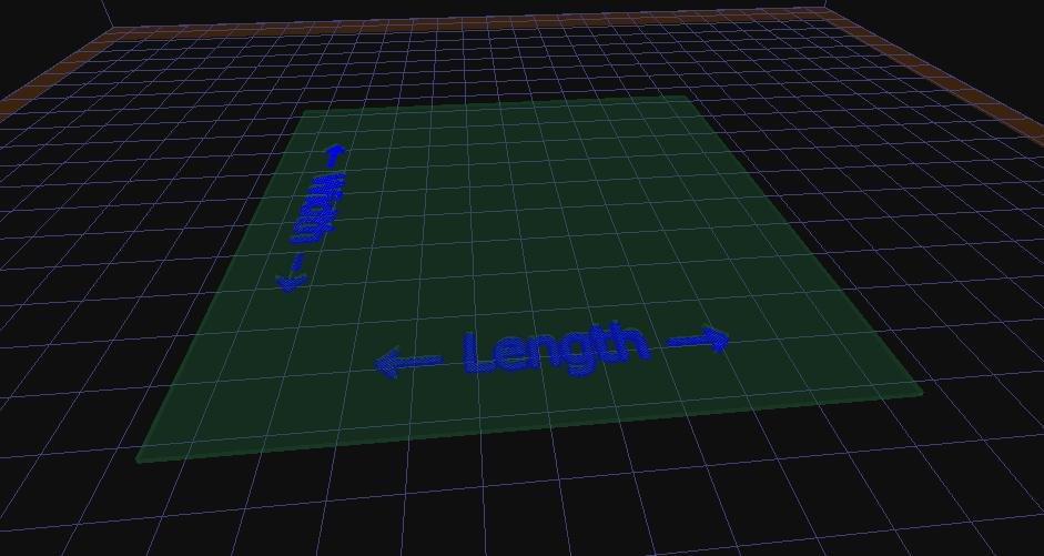

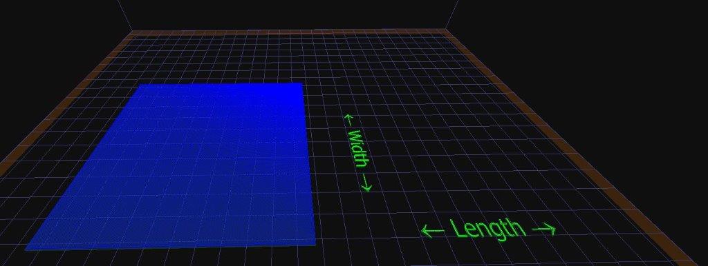

I have two stls, one a flat rectangular board, the other is letters that are to be printed on top of the board (see pic 1). The board and letters were sketched and extruded in Autodesk Inventor with the letters sketched on top of the board. I open the two files together to superimpose the letters ontop of the board just like they were created in Inventor and assign Extruder 1 to the board and Extruder 2 to the letters. KISSlicer adds layers of letters that are not there and assigns them to Extruder 1 (see pic 2) even though all the letters are assigned to Extruder 2 and the letters that I assign to Extruder 2 are printed on top of the erroneous letters that KISSlicer erroneously assigned to Extruder 1. It appears KISSlicer is getting confused here.

Pic 1 - Letters On Top Of Board
stl Letters On Top Of Board.jpg (55.77 KiB) Viewed 3643 times
Pic 2 - Layers Of Letters Erroneously Added By KISSlicer
stl Erroneous Letters Added By KISSlicer.jpg (56.82 KiB) Viewed 3643 times

Well KISSlicer proved smarter than me. It turns out I was thinning the board down from 3mm to 1mm for a test print to save time just to see how the letters came out...and I forgot to re-save the letters that are sketched to the board surface which now had its height reduced. So KISSlicer, seeing space between the top surface of the board and the letters, filled the space between the board and the letters with a loft of sorts, that is it used the board mesh to create letters that joined up w/ the letters in the letter's mesh. Hope that makes sense.
