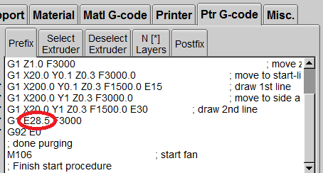

Small problem with retract filament in begin procedure. Retract length is always 1.5 mm regardless of the setting destring_suck/destring_prime.

Have you checked that are selecting and are adjusting the correct material from your library?
In the material name tab it should show which extruder number has been assigned to your material. Double check to see if it matches

OK. If I change destring Prime/Suck mm on page Material, I must also manually edit Prefix Retract filament on Ptr G-code page. For example, destring 0.5 mm, retract filament in start procedure must be 29.5 mm.
