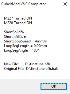

Hi
i am new to this so maybe im missing something.
I started tying kisslicer ver 1.4 something and v4.91 of cubeitmod, i and had some problem with infill and solid settings not working as i expected so after googling it i found this forum and downloaded V1,5 beta 2.22 and cubeitmod V6.0.
But now i see this. How can i change the settings for short infill & solid?
And the biggest problem is my G-Code.
I get a #IND instead off a number??
I can see that the file .bfr.bak is ok but not the .bfb so i guess it´s something i missed when setting up cubeitmod?

Hi Floppen,
did you use the "po" and "ini" files included into the zip ?
I think not.
If so,
1. make a copy of your ini files you have into Kisslicer's folder
2. copy the ini and po files included into the zip file into the Kisslicer's folder
3. run Kisslicer , go to the menu Préférences->Languages->Load a language file and select the CubeItModV6.po file you have copied into the Kisslicer's folder
4. The Solid% now called S/I% (because works for Solid and Interface) and Infill% are into the Matl tab
The ShortSolid% and ShortInfill% are into the printer Gcode tab, ATTENTION change only the value not other things into these lines.
Here are my latest settings they are better than those I posted into the first message :
; InterfaceSpeed [mm/s] = 25
; ShortSolid% = 50
; ShortInfill% = 50
; SmallLoopSpeed = 4
; LoopSegLength = 0.4
; LoopSegAngle = 22
^Firmware:V1.07
G21
G90
I think not.
If so,
; ShortSolid% = 50
; ShortInfill% = 50
; LoopSegAngle = 22
^Firmware:V1.07
G21
G90
