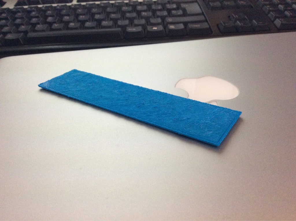

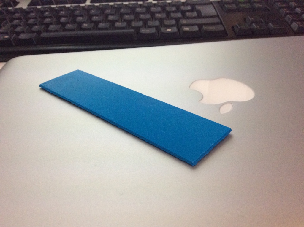

Recently when I start a print the first layers print perfect, something and flat, but when it remaches about 0.3mm or 0.4mm the nozzle seems to los se the Zgap and starts to touch the printed surface making the material melt and ugly...
Any idea?
This is from the base layer, and it's ok

Sorry the first image is from the base layer, the second is when it begins to fail

Some points to be evaluted:
1) Z axis movement is precise, slack free ?
2) Filament diameter is set right ? (seems a bit overextruded)
3) Z offset seems a bit too small or bed roughness is set too high.

That's definitely a sign of overextruding. Whether it's the layer heights being less than they're told or extruding more than you're supposed to is up to you to find out, but I'd just reduce the steps per mm for the extruder or increase the filament width setting in Kisslicer.

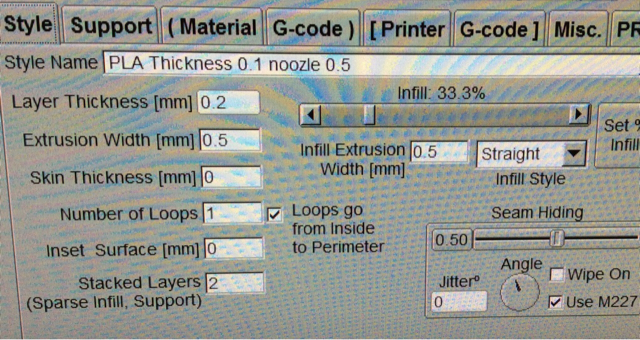

I'm still learning concepts so a bit confused am I ;)
That's my setup...
At afternoon I will try the tweaks you asked to do.

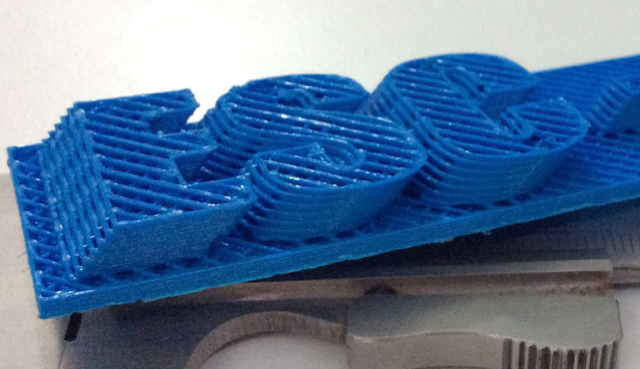

Changed the gain on extruder 2 and 3 (I'm only using second extruder) , also increased a but the layer height, from 0.1 to 0.2, and reduced the infiel from100% to 33%...
This are the results:
How can be possible the diagonal offset, only on the letters? The base is ok.
And why didn't cover the surface? Only shows the inside structure.
