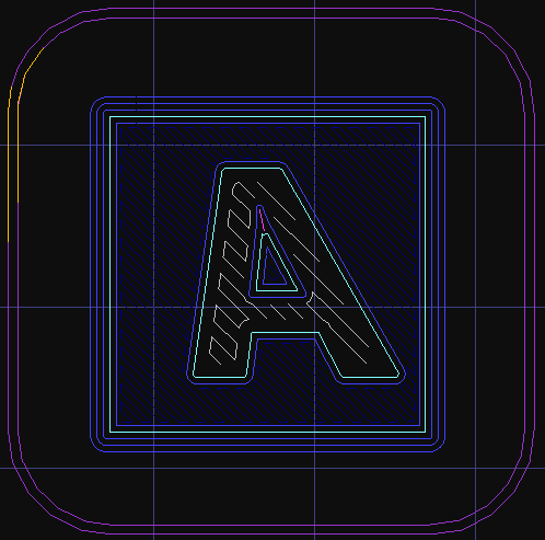

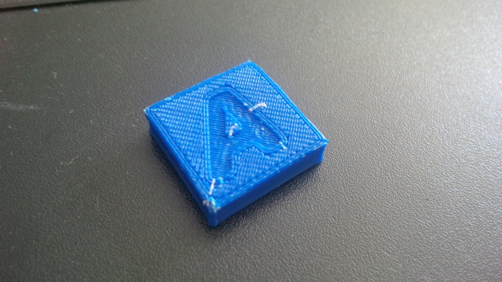

Hi all
After testing several parameters, i still have bad path and/or bad infill and/or bad extrusion for the first object layer on a raft.
here is my problem :
Slicing :
https://www.dropbox.com/s/6rmdsg1e45gtb ... 4.PNG?dl=0
Result :
https://www.dropbox.com/s/un2kdw1er2h74 ... b.jpg?dl=0
Have you some idea(s)?
Regards.

Post by PenskeGuy »
In the KS path display, I'm not seeing the Infill paths, as-sliced. Have you run a Thin Wall and Solid Cube Calibration? It looks as if the Loop/Solid Infill Overlap value, and/or the Flow Tweak, could be adjusted; as there is a gap in places along the outside, as well as along the letter edge.

Hi Penske & Davide
PenskeGuy wrote:Have you run a Thin Wall and Solid Cube Calibration? It looks as if the Loop/Solid Infill Overlap value, and/or the Flow Tweak, could be adjusted
Yes, Flow Tweak and Gain are calibrated (and weekly checked)
For Loop/solid Infill Overlap, I will make tests with changing its value, actully set at 1.0
But...perhaps my eyes doesn't see what to see...here is the upper side of the concerned print (same as viewtopic.php?f=13&t=564 )
https://www.dropbox.com/home/KS?preview ... -layer.jpg
And external dimensions of the final print are correct with nice tolerances (certified digital caliper, average of 5 measures) :
Z height : 5mm at +0.01/+0.02mm
X/Y : 20mm at +0.08/+0.1mm
@ Davide : ok, I send it to you.
Edit : and Style\Infill is set at 16.7%
PenskeGuy wrote:In the KS path display, I'm not seeing the Infill paths
I cut it for publishing, it begin at z = 2.34

I said: "in the KS path display". I don't want to look at the G-code, I want to see what KS is doing with its paths at those letter borders.

Here is a pics of the concerned layer :

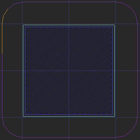

Here is pictures.

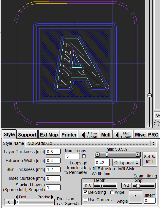

I made a test with 0,3mm layer thickness :
Result :

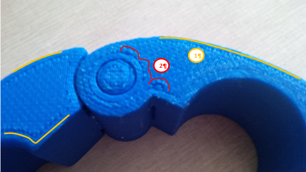

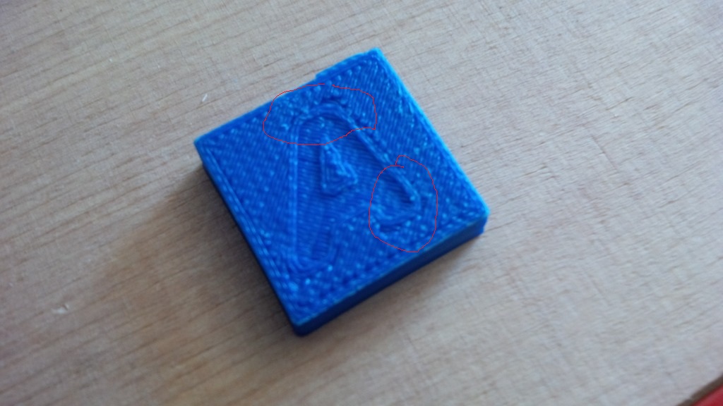

Here is another print :
I have observed the print process and, I can clearly say, only for first layer parts, that :
1. the infill path seems "too short" at 180° corners (even loop/solid Infill Overlap set to 1)
2. while printing, sometimes, the nozzle "stop/do 180° corner" before reach/overlap the internal loop perimeter.
For 1 : In Style tab, KS should propose a parameter which will increase the first layer infill path length at 180° corner of a coefficient/multiplication of extrusion width.
For 2 : I have no idea.
