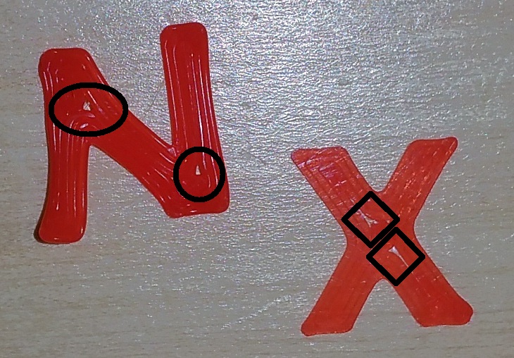

I'm getting tiny gaps in some of the lettering I'm printing on a box. Attached is a picture showing the holes.
Also attached are the two stl's I used to print the box and text. I made them zip files so I could upload them.
Any idea how to eliminate the holes. Cura can print the lettering w/ out holes, so I'm wondering how to tweak KISSlicer to do the same because KISSlicer makes a nicer looking part overall...just gotta deal w/ the holes.

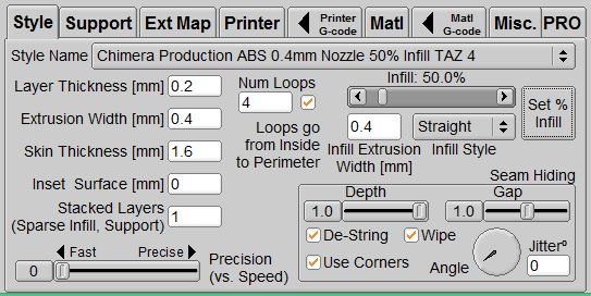

I also attached my Style settings for reference.

- Gaps In Print - Style Settings.JPG (52.98 KiB) Viewed 5466 times
