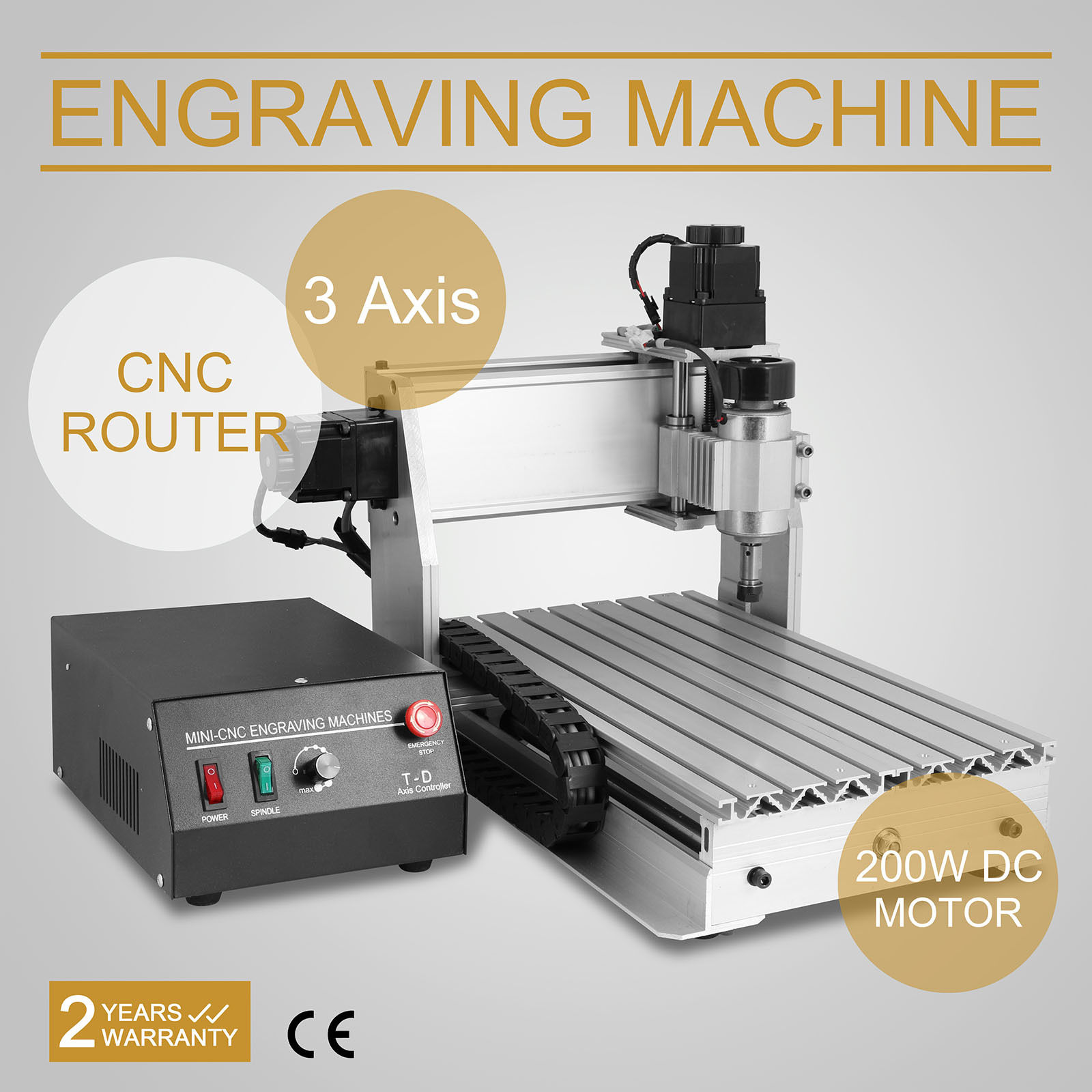

Yes it's parallel driven, 3020T(Picture). I've had it for about 5 month's already. I use it mainly for PCB boards
and it's been doing fine with those.
This is the first time I tried to convert an stl file to gcode. Yours was the 1st one that didn't spend 1/2
the night building the toolpath/gcode. The other built it and LinuxCNC loaded it fine, but has several size issues
that making a small adjustment takes forever just waiting for the toolpath to be generated.
