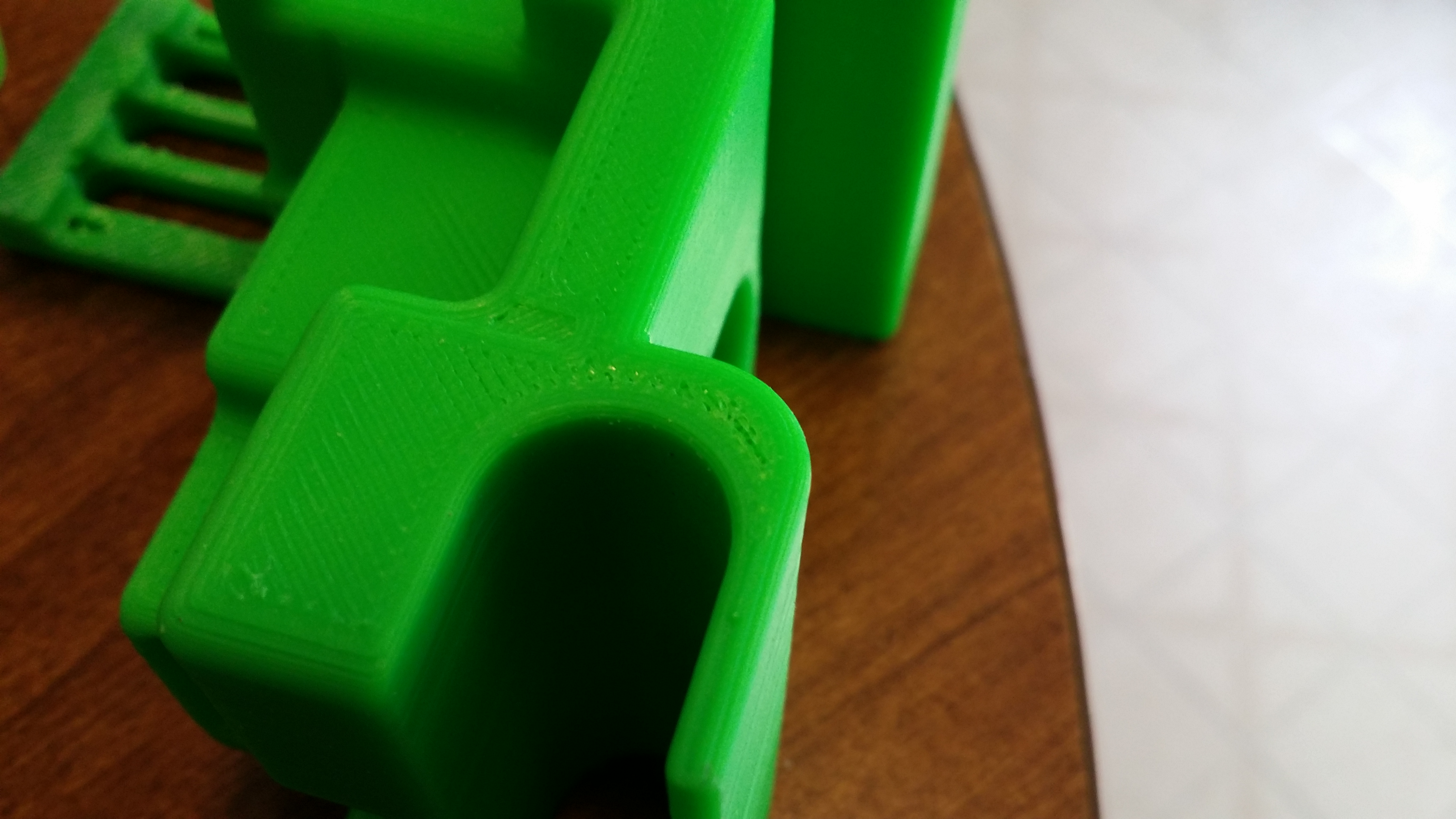

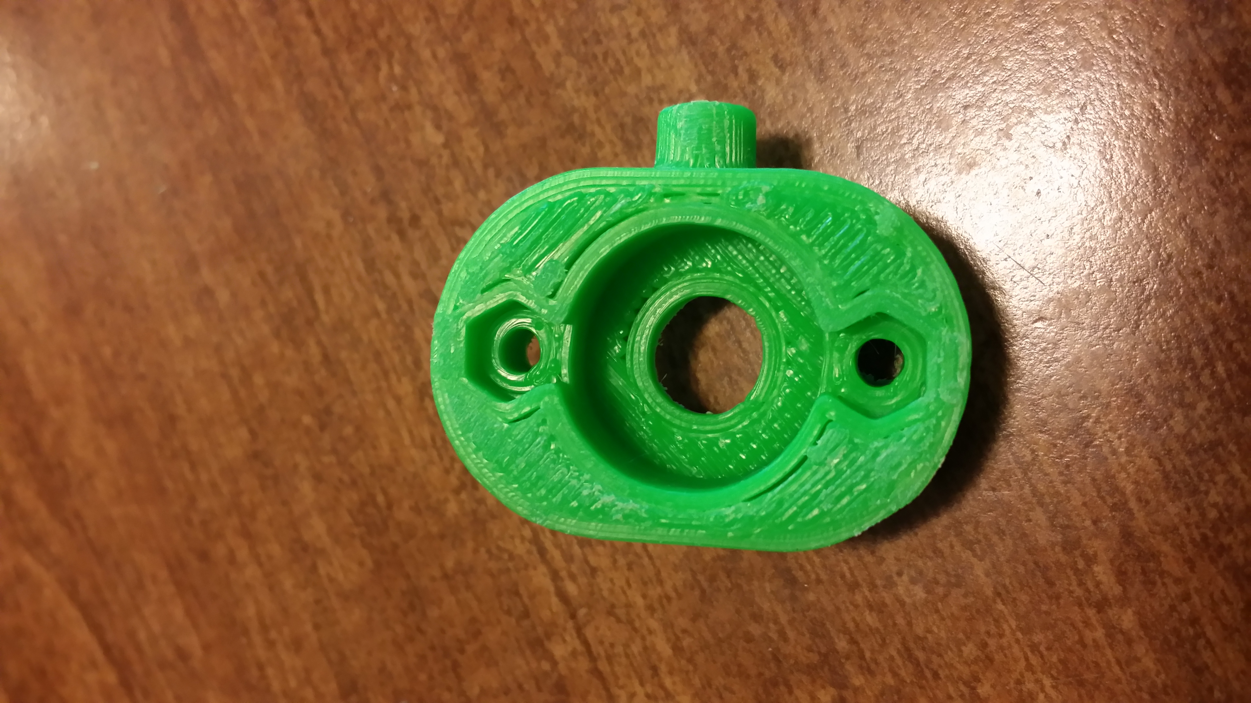

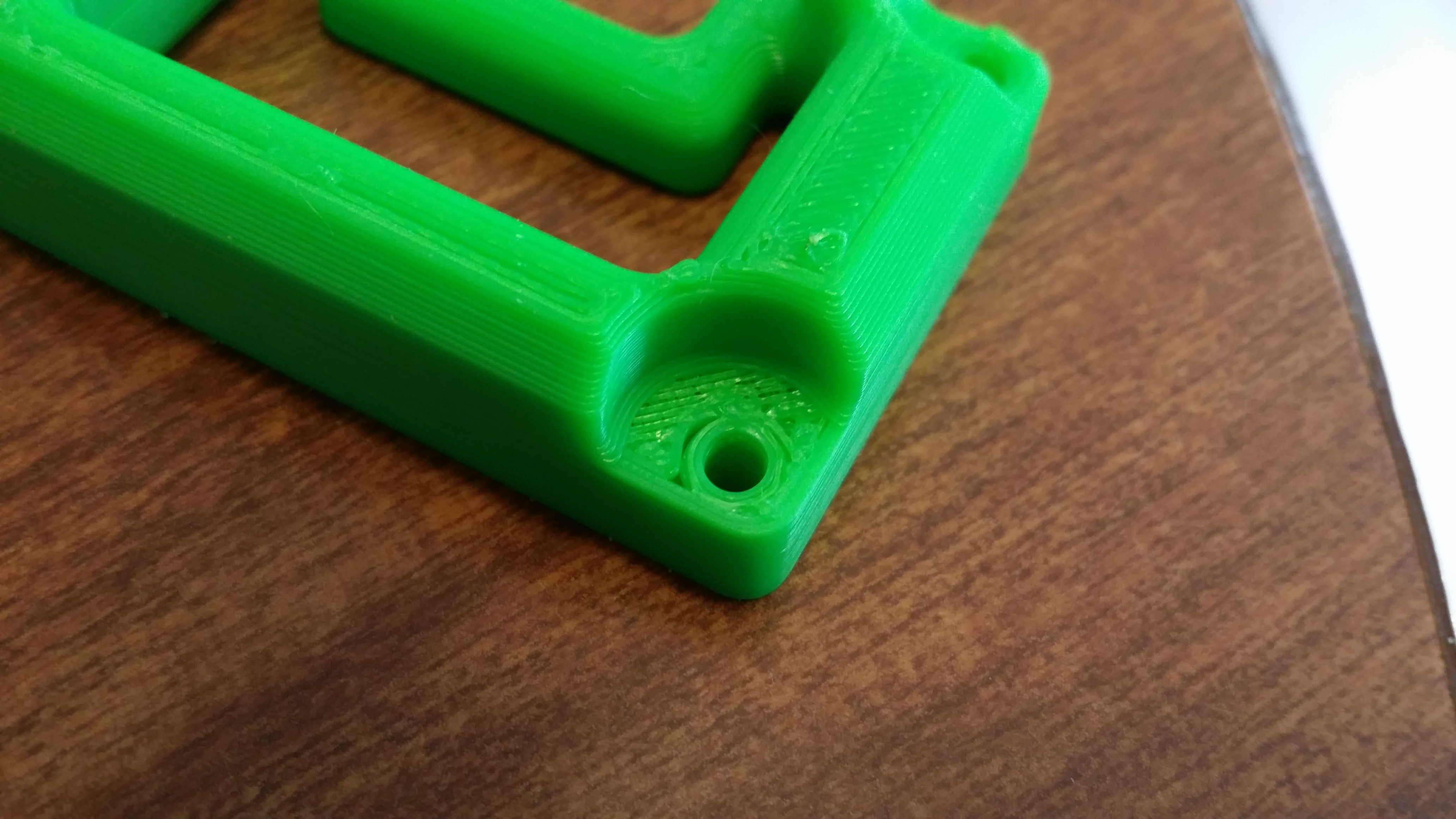

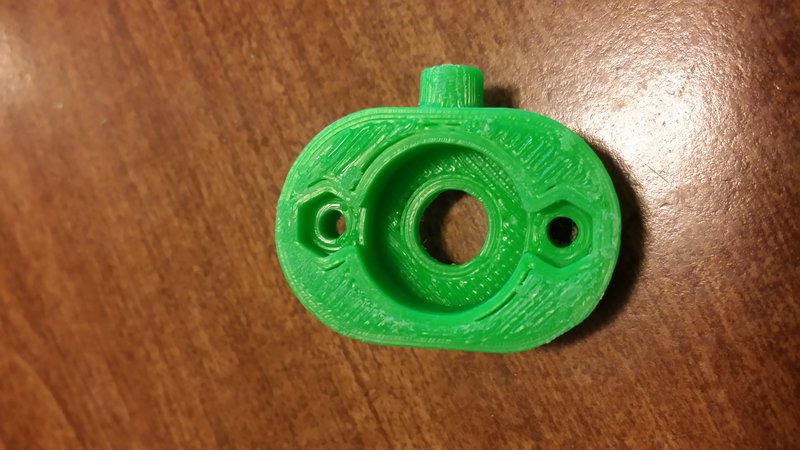

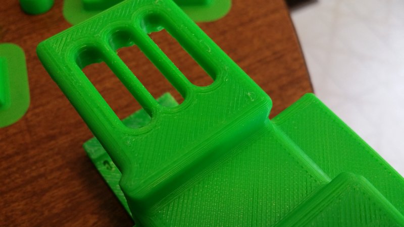

Hello!

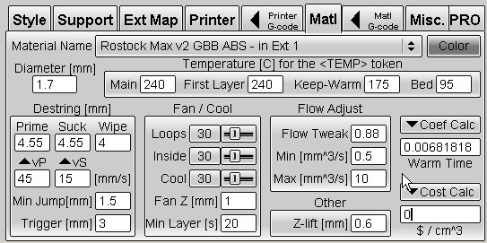

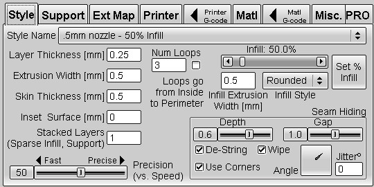

I'm a new Pro member to KISSlicer and pretty new to 3D printing entirely. But so far I'm having really good luck with KISS and my Rostock Max v2. The only thing I'm noticing that bothers me a little is my top layers are not filling completely around design holes and there are little openings in places, almost like a screen. This is very minimal, but still not perfect (OCD kicking in, lol). I was first thinking that maybe my extruder calibration was off or maybe my extrusion multiplier but checked both of those and they look correct. My 20x20x10 calibration box is showing a perfect .50mm wall size (which is my nozzle size and layer settings). So which setting should I change to help this issue?
Maybe this is normal, I don't have any other 3D printers to compare to in my area, only pictures online. So let me know too if you think this looks "OK" and will still be strong parts?
It's kind of hard to see in the pictures so I'll load a few different ones.
Thanks in advance for your advice!

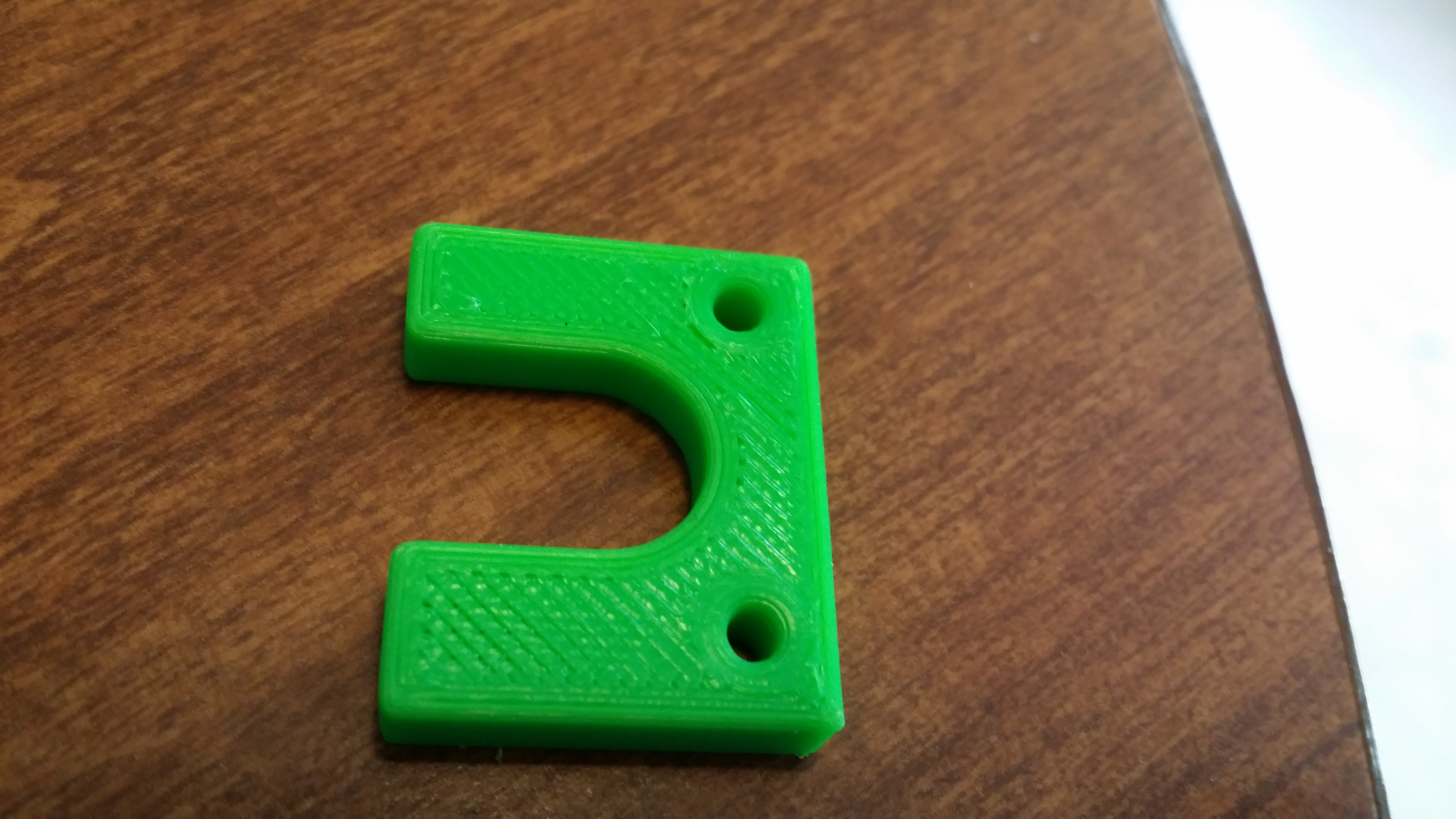

Here's a better picture that shows what I'm talking about.
Thanks,
J

Have you performed a complete calibration, that includes a Solid Cube; not just the Thin Wall Test? Check Davide's manual or use my original instructions (attached).
WTF?!?!? Extension PDF not allowed? Are ya kiddin' me, here??? OK, just strip the ".zip" off the end and you're good to go.
thin-wall-solid-cube-calibration.pdf.zip
(57.34 KiB) Downloaded 352 times

Thanks for the document! I did all these calibration procedures again from the PDF and I ended up with the exact same settings. The prints turned out perfect. So the only things that changed was I reset all my custom g-code (which I had download from someone else's settings on the seemecnc forum) and I made my own cube like recommended in the document, rather than using the one from Thingiverse. So either the things I'm printing from Thingiverse are defective STL's or there was something in that custom g-code that was messing me up.
Think I'll need to only make a few modifications to the default g-code. It's starting to print before my bed reaches temp, and it doesn't home the hotend at the end. That's all!
Thank!
