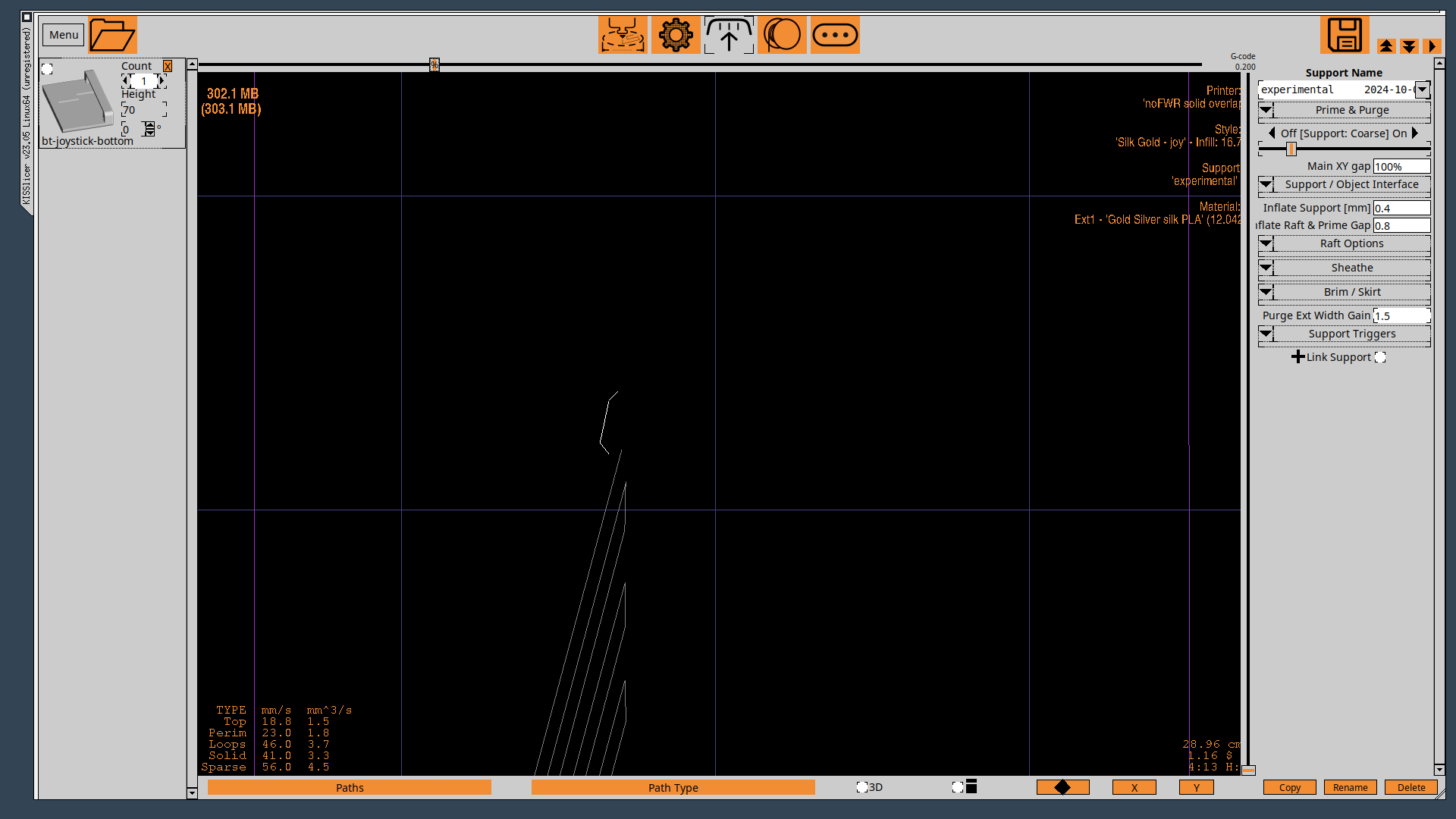

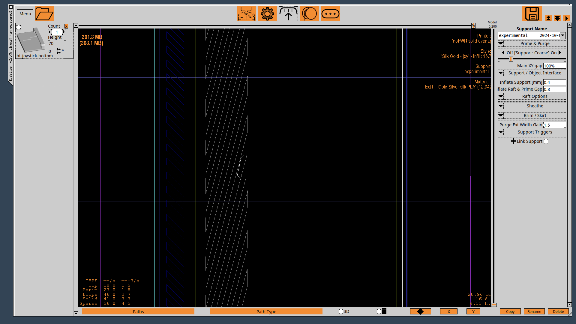

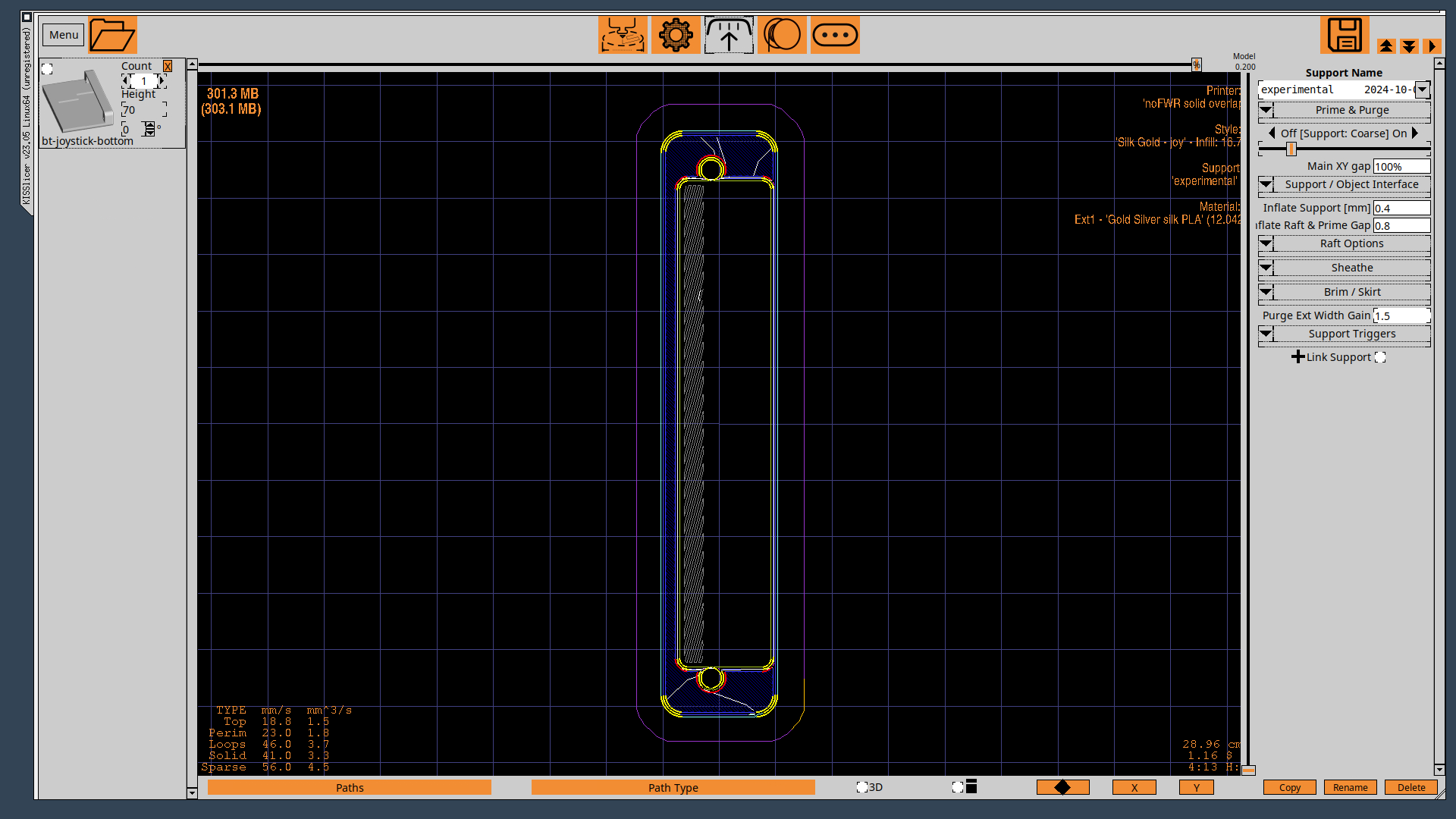

When printing the first support layer, Kisslicer suddenly decides to make a small jump. What is the reason for this? And yes the printer really jerks at this point.

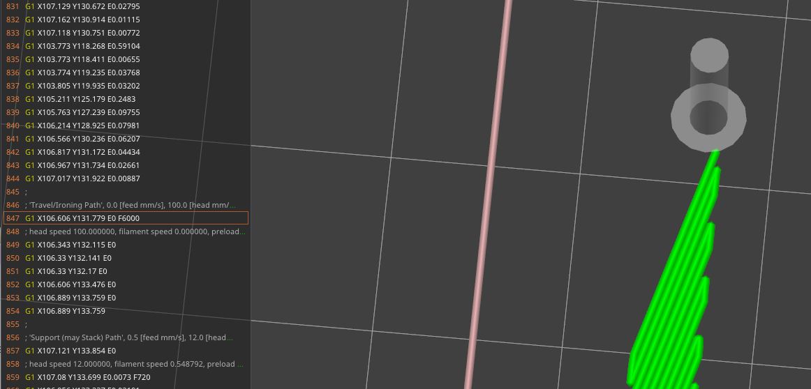

Unfortunately I couldn't find this place in GCode quickly because I didn't understand how to interpret the ‘GCode 0.200’ above the scroller.

Re: Jumps in supports
Very strange.
There appears to be a Travel/Iron Path in the middle of a support print...
Will pass this on.

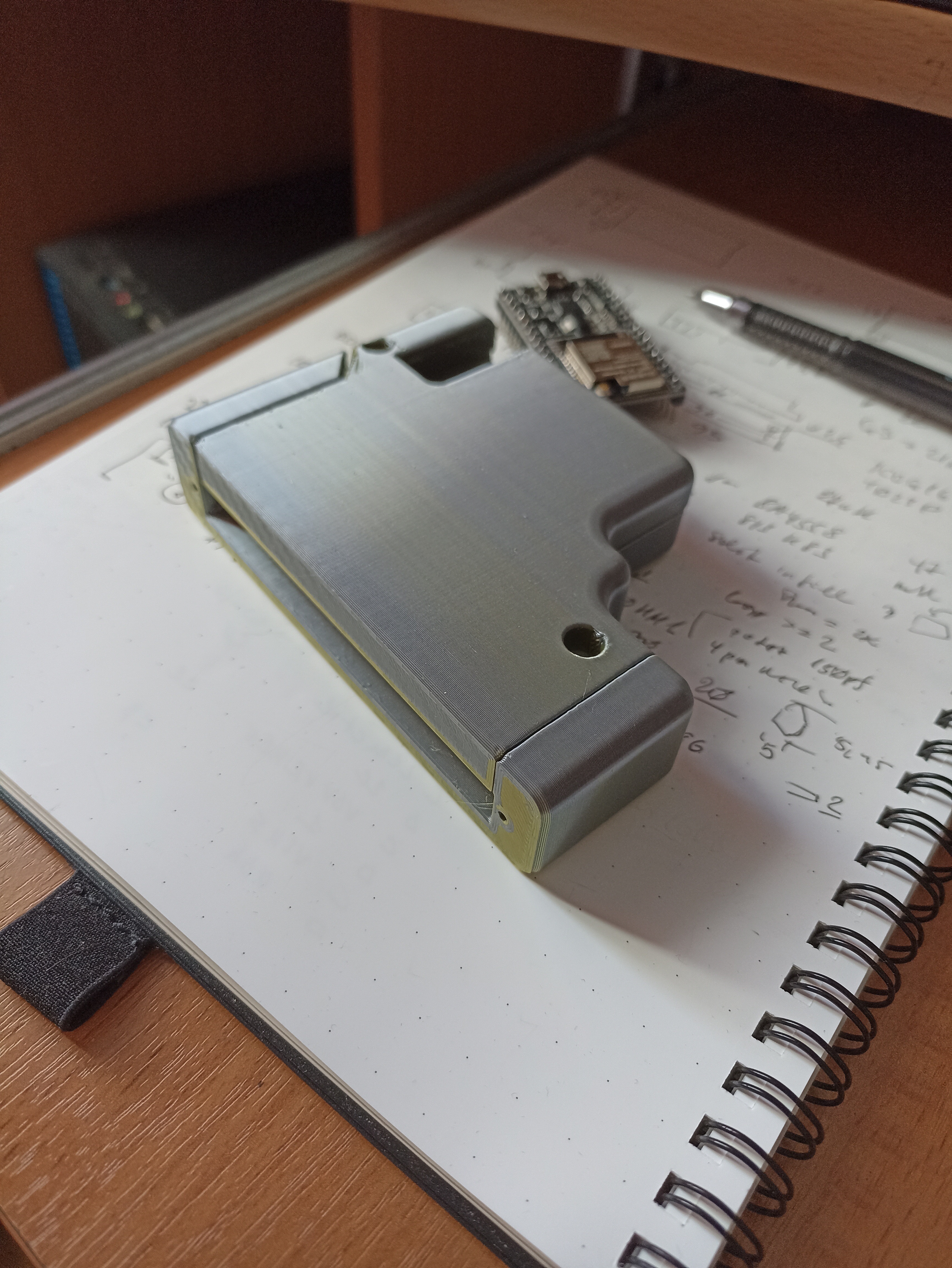

Yes, this is the model file.
And its descendant printed from silk plastic (using KISSlicer ofc), redesigned so that it does not require supports ;)
