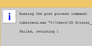

See attachment.
Anyone know what I am missing?
I have tried a few different files and the same thing.
Please help
Failed, Returning 1

Hi Tesseracttech,
the file you have specified in Kisslicers Printer Firmware Tab needs to be located in the same folder as Kisslicer itself. Make sure the name is correct, in your case you have specified cubeitmod.exe, so there needs to be the cubeitmod.exe in the Kisslicer directory.

Re: Failed, Returning 1
The error come from the post proscessor line in printer/firmware tab.
Please read tutorial on my website to check your setup.
Also the good couple between cubeitmod and the last kisslicer can be found on this thread :
viewtopic.php?f=20&t=442&start=40
There is more option on this version but it can work well with the standard options.
