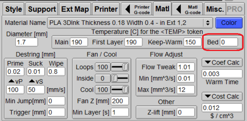

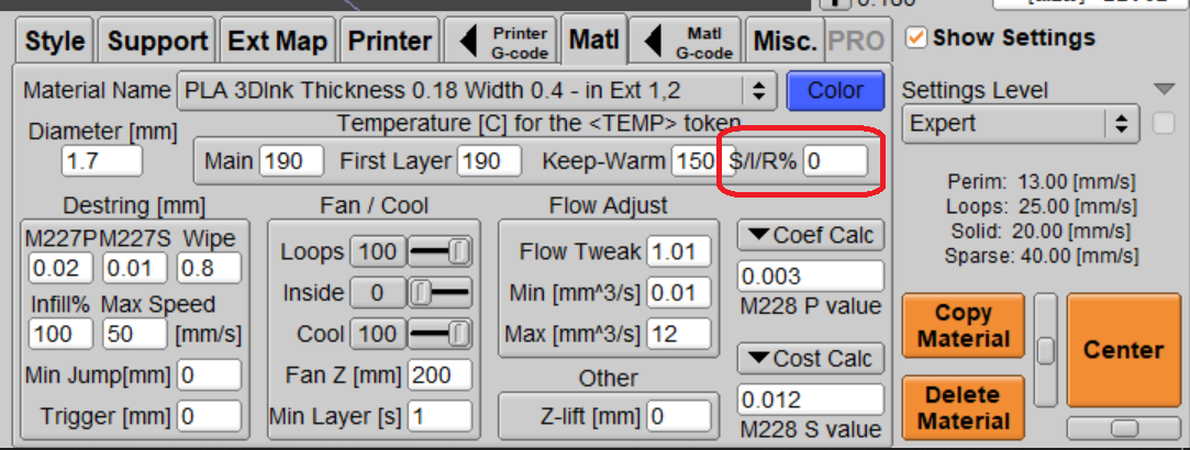

did you load the language file into kisslicer "cubeitmodv6.po"? the S/I/R% will be set from bed Temperatur. i've got same error when i set bed to 0!
Kisslicer normal window
Kisslicer std.

kisslicer after laoding ".po" file
after loading po file
i hope that helps
