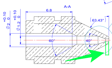

Just want to confirm that nozzle lenth is the "thickness" of the metal where the nozzle opening is. Is this correct?
Or in other words (pictures) the dimension shown here:
Also this nozzle has weird interior shaping. I previously (mistakenly?) Thought nozzle length was the entire nozzle's "height" and was using 13mm. Switched to what seemed to be the "correct" measurement (was later informed that it is 0.5mm) but am getting much worse preloaded results and destring results.
Anyone got any ideas? I'd rather not play entirely by the guess and check method... I thought thats what the wizards were there to prevent...
