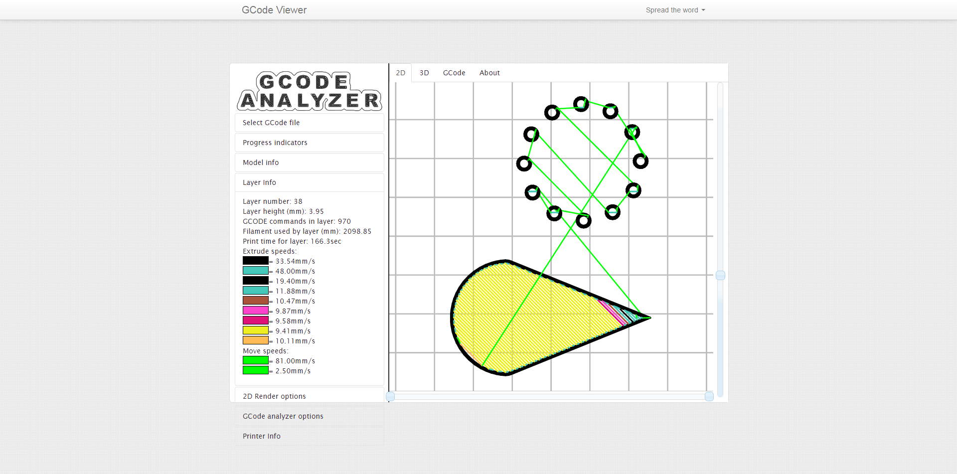

About speed allowed by the cubex. We have to differentiate speed, short and long segment, max allowed speed for small segment is smaller than the one for long.
You can try this to see, slice a small cylinder with 50 loop and watch your printer doing circle, long are done at full speed, but when doing small circle it's going slower. Hardware cannot reach 48 mm/s in 3 mm... It's why really high speed is not necessary and can cause a bug into the firmware resulting over extrusion. I advice to not go over 100 mm/s before bug.
I'm now testing the shift function, i will post pictures to compare them.

CONGRATULATION !
it's a perfect finish with values in prefix tab you give in example in a previous post. Theory is good !
I used 48 in max speed.

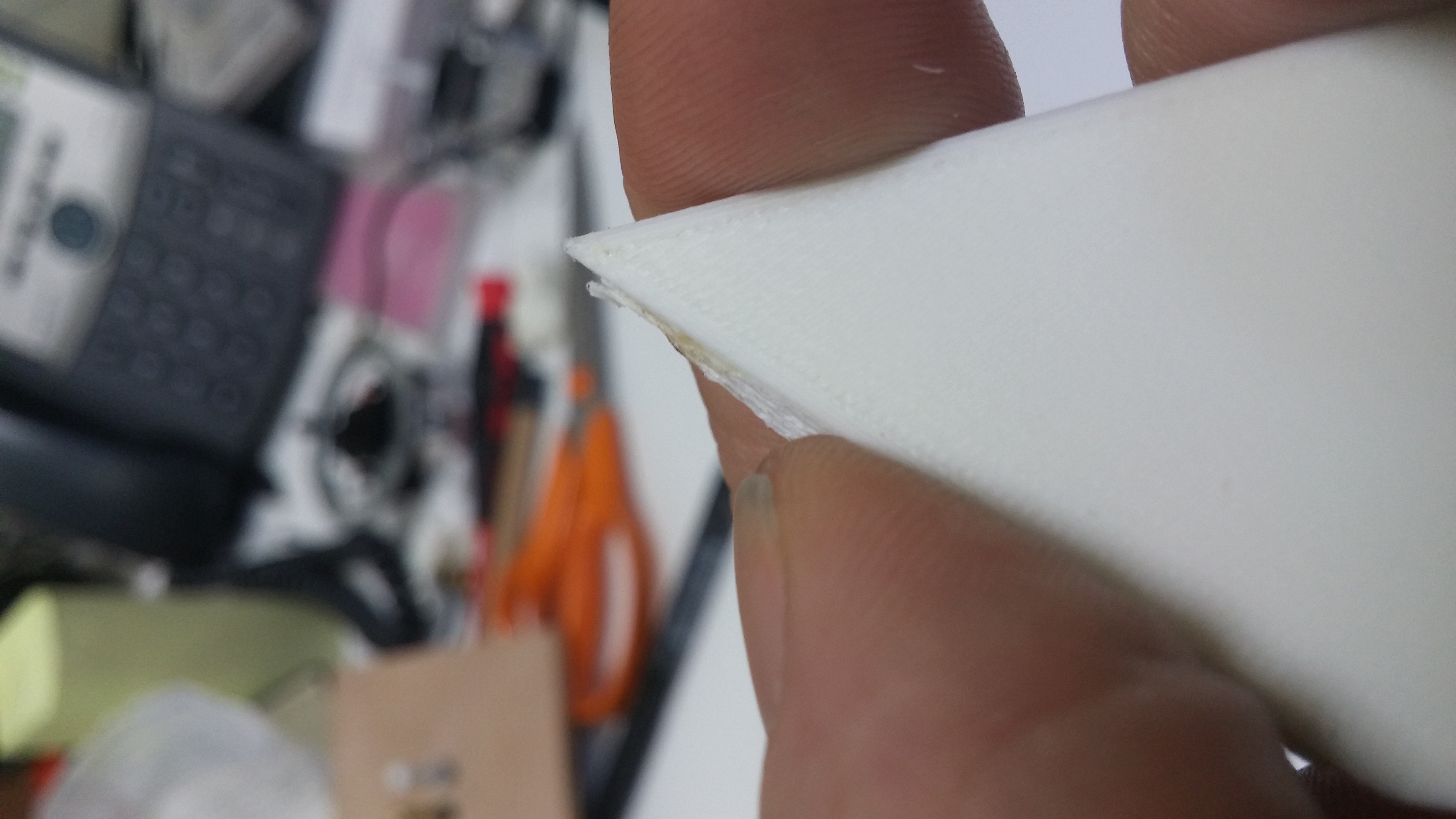

Hi Joe, Tobbi
For this test i use ABS reprapper filament. long time without printing ABS, so i wanted to find a good setup for it....
I used my cubstom with a 0.3 nozzle so careful with higher nozzle or stock one, prime and suck would not be the same.
In Style tab :
0.1 mm layer thickness
0.9 mm skin
3 loop
Stacked layer ; 1
infill 10%
0.5 in depth for seam 0.7 in gap
No wipe (otherwise it's cheating )
Printer :
speed 36/36/32/32
Prefix :
; Shift = -2
; HighLimit = 1.05
; Exp = 1.2
; MinLength = 0
Material :
Solid% 100
Infill% 100
Max speed 48
M227P :0.02
M227S: 0.1
M228P: 0.01 (next time i will try 0)
M228S : 0.01
Tests are really hard to shoot, but the shift made lot of change in the surface finish, i tried it to 1 and it was better than 0 and when i tried -2 with all other values, print was really good.
