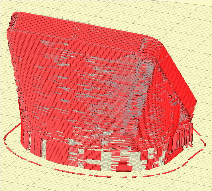

Well actually, a little update, it doesn't print with ABS as well now...
This is how the model looks like when loaded to pronterface after slicing with Kisslicer:
You can clearly see the jagged lines and it doesn't extrude any material when it comes to printing.

I think I found the solution.
In Printer -> Firmware tab I changed the Firmware Type setting from 5D - Relative E to 5D - Absolute E and it seems to have fixed the problem.
