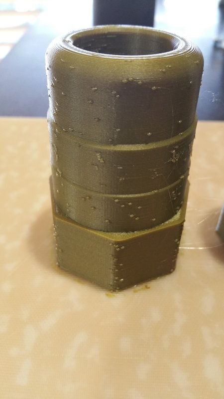

Hi Everyone,
New user of Kissslicer and of 3d printing in general. I have been getting some very nice prints but occasionally, especially with cylindrical objects I will get these over extrusions and I was wondering if any of you had some ideas for where I should begin to rectify this issue. I would appreciate any feedback you may have.

I think it's a seam problem with a jitter setup to 360.
Try to uncheck this box in style tab and play with the prime and suck function in the material tab. You will have a straight seam easier to tweak.
Hope it's help !
