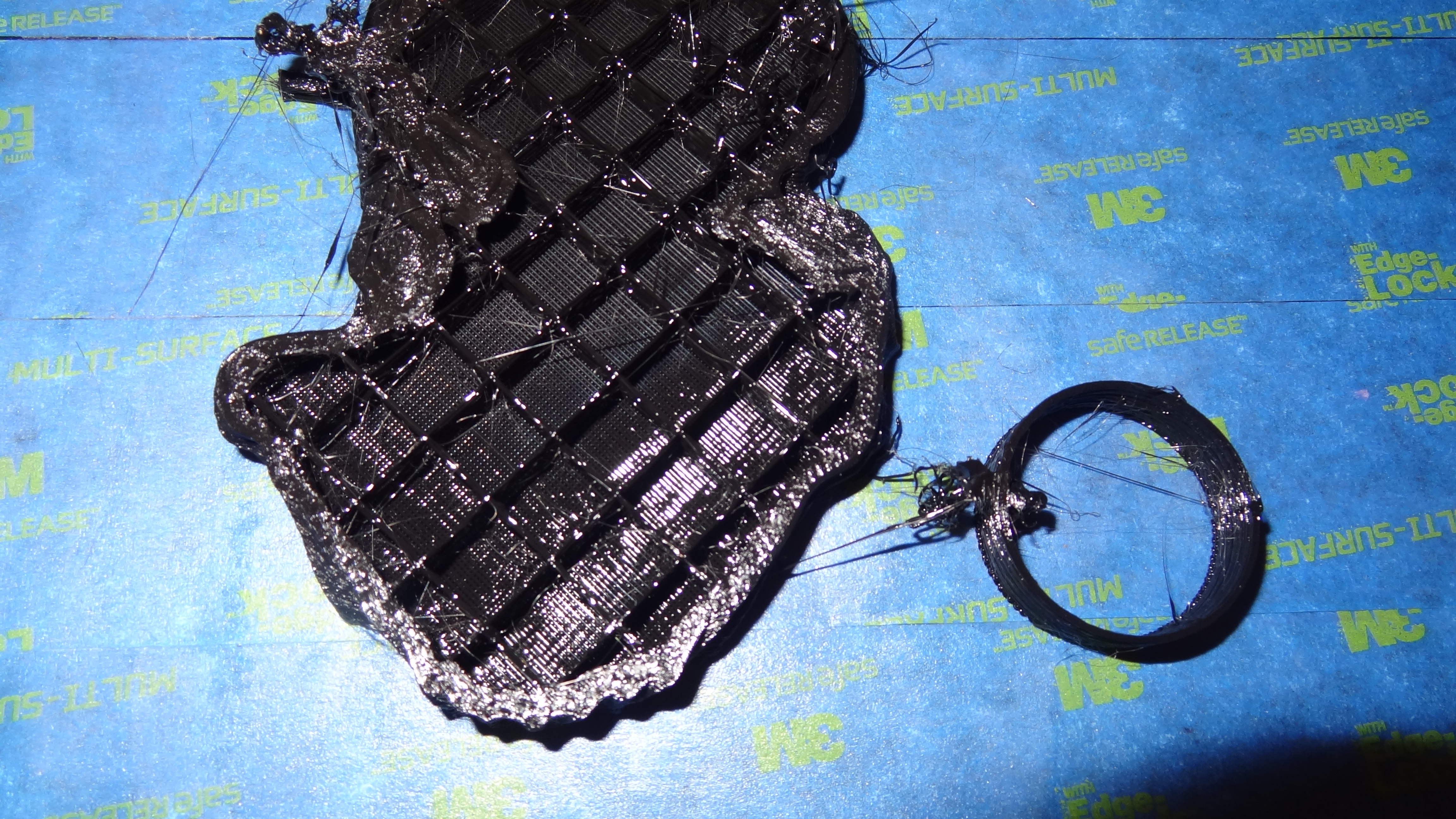

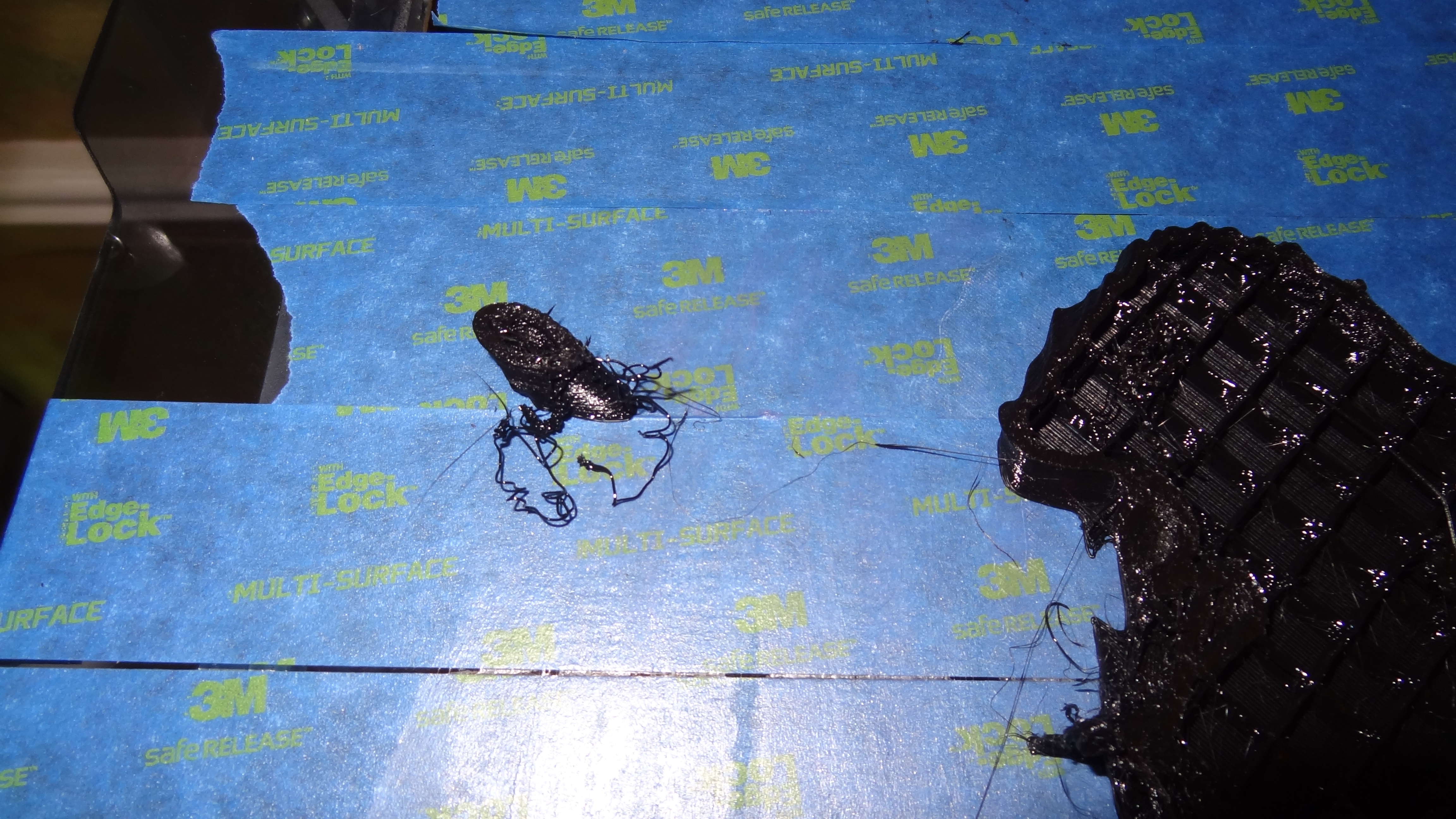

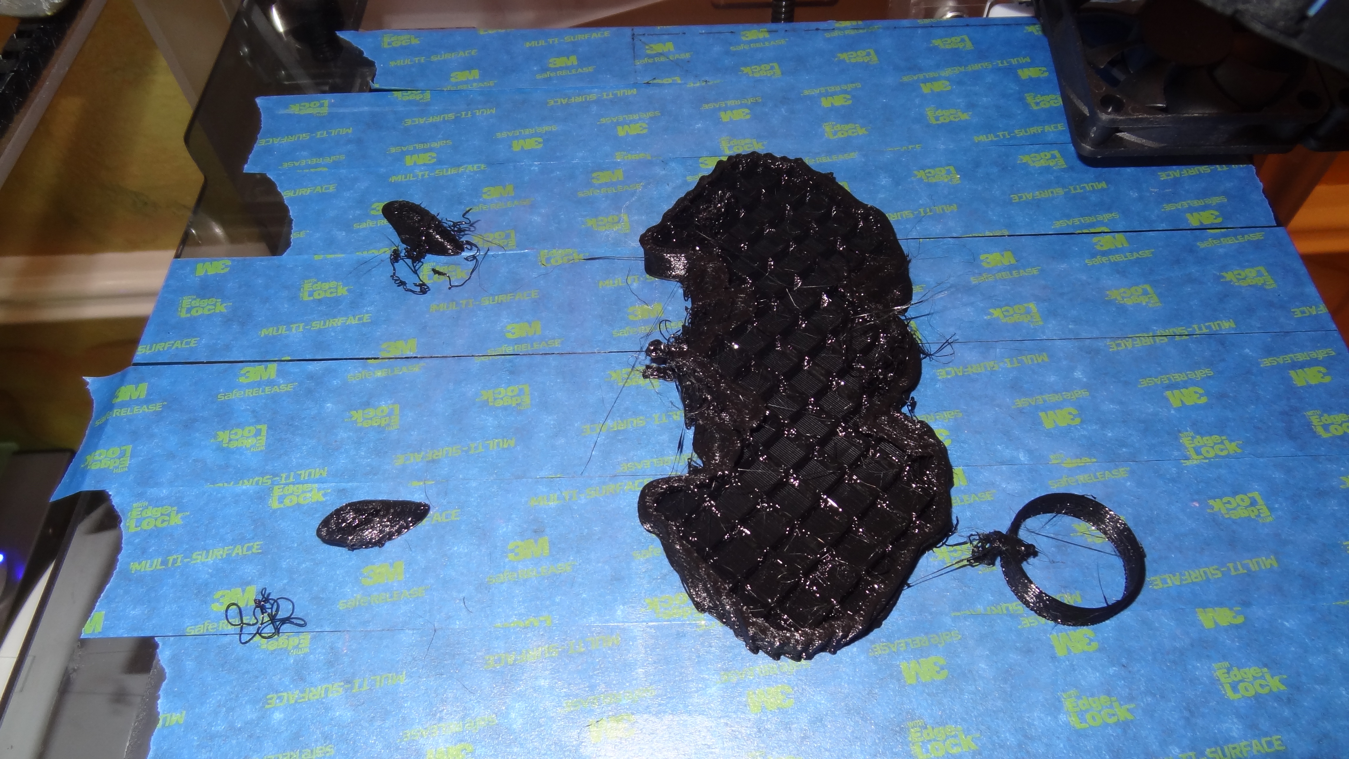

Hi guys I am a newbie and I am having some issues tweaking Kisslicer with my cubex . My prints start out fine but along the way I start getting some stringing issues . can anyone suggest anything or better yet is there someone in the Houston who I can talk to .

It's could be two thing in your case:
- M227/M228 parameters in the material tab. Decrease the M228P increase the M228S maybe... Post your material setup to see the starting point
- Over flow rate, not sure with the flash light but it 's look like. Did you setup your material in 3 steps ? 1 loop thickness / solid infill / seam ? If you did this correctly you're result could also be a weird bug of cubeitmod. Check on my website there is a safe version who prevent this.
I didn't test the last beta of kisslicer with cubeitmod but i think it will not work correctly due to the new PS function. Which version are you using ?
