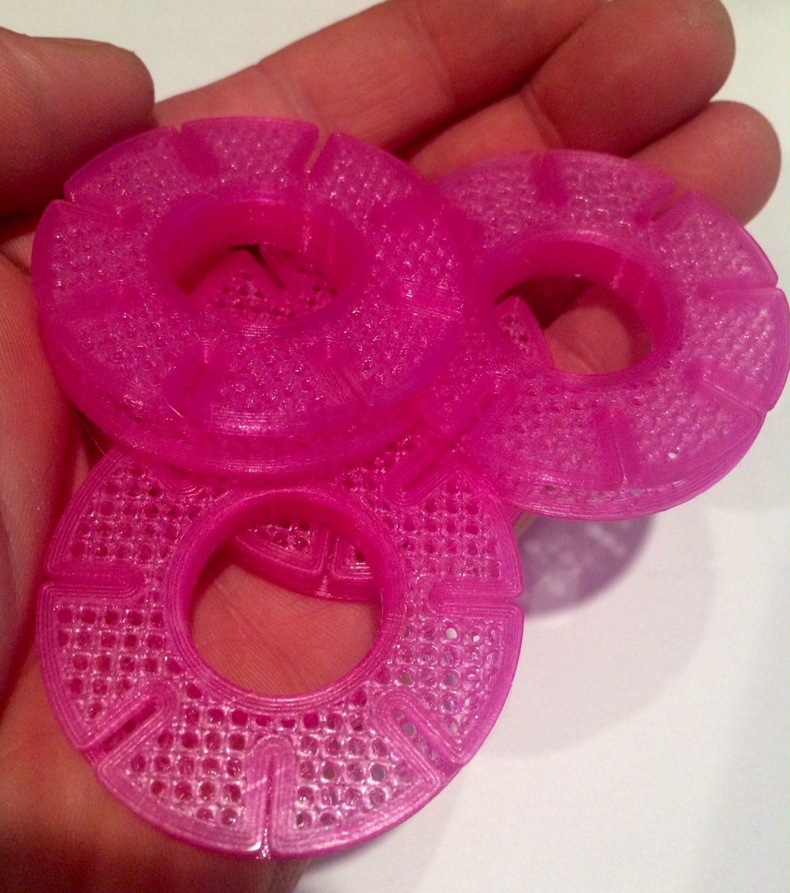

Many rapid suck/prime moves in quick succession can often lead to jams - especially with PLA that seems to exhibit more thixotropic behavior. Ideally, you'd like to have a fast suck to "snap" the filament into the nozzle to minimize/prevent oozing and a slow prime move to not "micro jam" in the hotend. I've spent an inordinate amount of time studying this behavior. I can 100% reproduce this hot end jamming problem on a specific part I have printed in PLA with 40mm/s prime/suck speed. I have written a script to process the gcode to change the prime to 20mm/s (leaving the retract at 40mm/s) and the problem completely goes away. Sneak the prime speed up and at around 30 mm/s the jamming problem starts to pop up again.

I declare this implementation a success! I am now able to automatically generate gcode and not have to post process it to get fast suck (50mm/s), slow prime (20mm/s) and getting no blobbing or other artifacts with PLA. AND, the dreaded "hydraulic plugging" phenomenon that I attest to the thixotropic behavior of PLA is not there. My torture test part will "plug" most hot ends or poor gcode unless suck/prime is very slow. Now I can print these faster and reliable.
