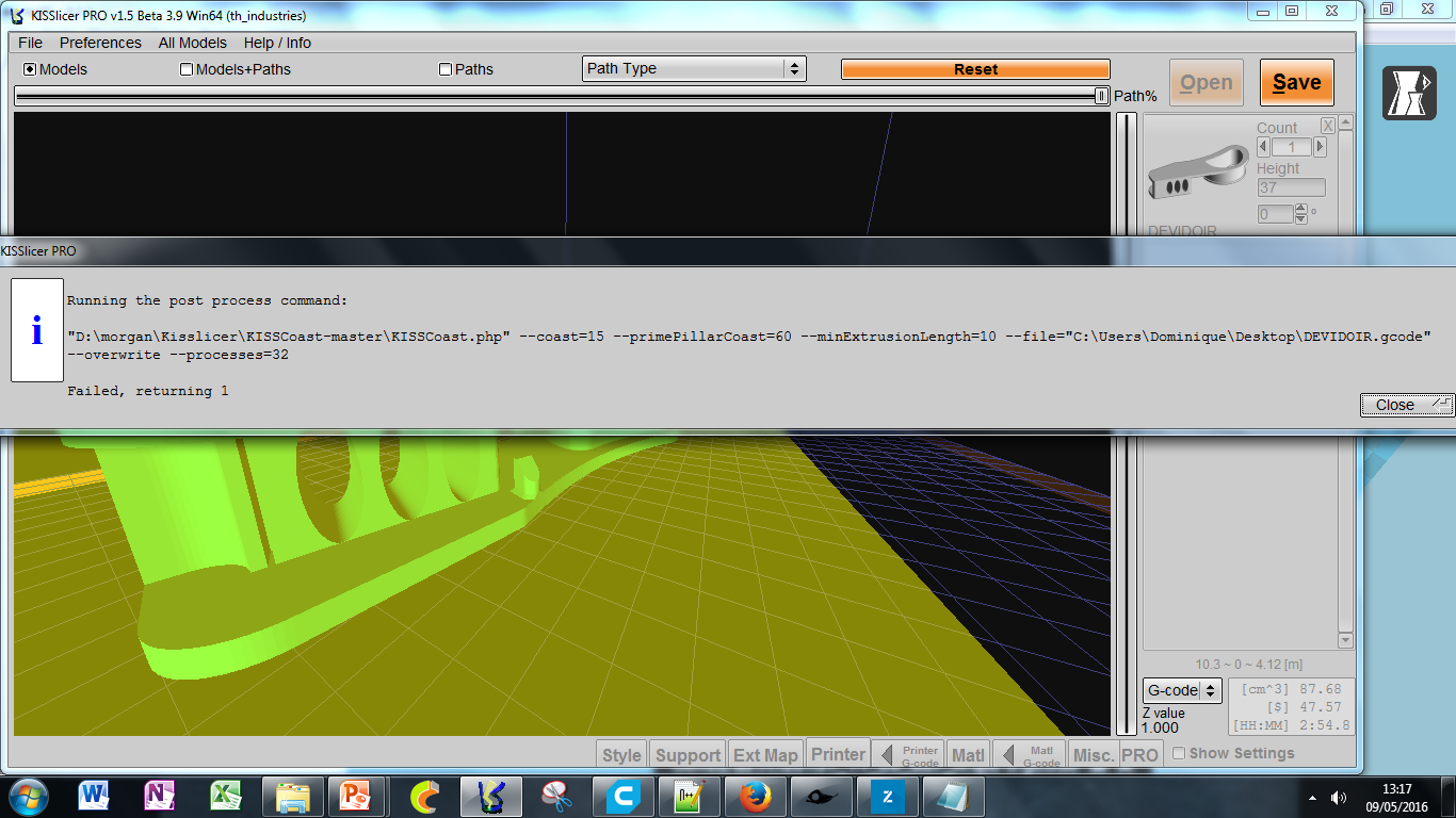

Hi all and thanks Jonathan for these new versions.
I tried the 626Pilot plugin but I m unable to launch the Post Process command.
Someone know where I did a mistake ?
Have a nice day all.
Morgan

Morgan, you can make an intermediate batch file that has a "pause" command at the end, so you can see what happened.

It would be better to talk about that in this thread: viewtopic.php?f=12&t=1265&p=3581#p3581MorganTH wrote:Hi all and thanks Jonathan for these new versions.
Please make sure you've read all the instructions on GitHub.
