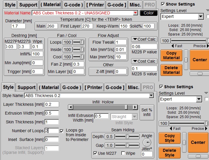

Hi, I've got some pretty bad prints; they're a little hairy but worser is that the seams are horrible at some places.
I've played around with the M227/M228 settings but with no luck. Please help. :)
Here is my settings and my https://www.dropbox.com/s/iryyg44smgau4 ... 1.stl?dl=0.
I've only printed a few layers since it was wrong from the start, but the bad seams were on those antenns (the lying, very thin objects).

I would try something like this with ABS :
M227P : 0.08
M227S : 0.15
M228P : 0.0001
M228S : 1.4
Otherthing to do, play with the depth and gap setup in the Style tab. If you see a bump try to increase the gap, if you see hole decrease the gap.
You can orient the seem in the Style tab / Angle
regards,
Hugues

I tried the settings, and for some reason the plastic smeared out, as if to much plastic flowed out.

So Decrease the M227 P like you did previously: 0.03

I've decreased it, and now its hairy the seams are is bad as before. Additionaly there is big blobs at a start and an end of a seam. :cry: :(

M227P push filament before starting a layer and retract the value between "zone"
M227S is the speed
M228P is an additional filament push between "zone"
M228S is an other speed
Be careful, it's my interpretation...
