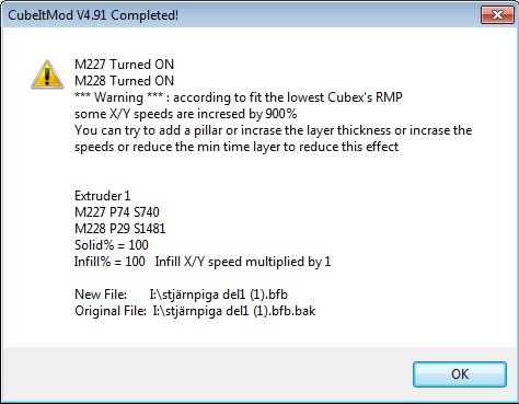

Hi, I want to print a model with a cubex printer but when I save my bfb CubeItmod gives me this message: "According to fit the lowest Cubex RMP some X/Y speeds are increased by 900%". What does it mean? Is it crucial for my print?

It's the repport of cubeitmob modifications. 900% is really hight !
To decrease this try remove the min layer time with "0" and use a prime pillar.

I can´t find the "min layer time" setting. Also I wonder if these M227/M228 settings are involved in this problem.

No, there is no relation with m227/m228.
The min layer time boxe is in the material tab/ fan cool section/ Min Layer [s]
Check if there is a value inside it.

Ah, it's there. I was searching in the Printer/speed settings. What should I set it to, 20 s?

No, set 0 and if your model need to be cool down, put a prime pillar

Thanks, but I wonder why I shouldn't that option. Wouldn't the layers slow down using it?

Cubeitmod adapt the speed to the RPM readable by the cubex. When you activate this function Kisslicer may calculate a really slow RPM and as Cubeitmod convert them in a readable value it increase the speed. It could be (like your case) too much.
The cubex cannot go down 0.1 rpm.
