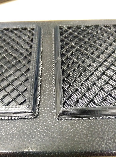

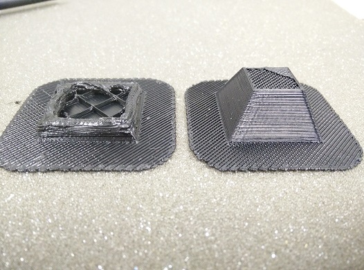

See on my photos:
On the left M108 rpm is not tweaked.
On the right M108 rpm is tweaked

Yes, horizontal zig-zag fills.
The example shown looks like what I see.
